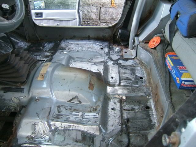

Ok, after seeing everything in new light today I decided to take on some more grinding and to check almost every inch of the inner tub. here are some pics.
Pass seat area cleaned up alot better with only a few small patches that will be needed.
The back section of the lower tub. Also cleaned up much better. One spot besides the seatbelt areas to be patched.
I also got to work on the area around the drivers floor pan patch. Everything that you can see that is still rusty is being cut out and replaced with new metal.
Thanx again for checking this out guys. Also, any advice besides pushing it off a cliff would be great.

My only other advice is to invest in a good tube of body caulk it seem like all mine is cracked and peeling out. You might find more rust in the seems like i did anyway keep us posted

My plan for those areas actually is going to be to either run a weld bead down each seam or spot welds till they are filled.

If I could make a suggestion - pull the carpet and back seat out before you go to crazy with the grinder and welder. An errant spark could put your whole project on the back burner - literally!
Good work so far - and I am probably going to start a project like this for my GF's YJ.... we found seatbelt bolts that are rusted into place with some small holes all the way through near where the bolts mount.

Yea, my father-in-law saw that this morning and i got a hand over the back of my head. This afternoon everything is coming out, roll bar comes off, carpet, seat and all the extra crap lyin around.
