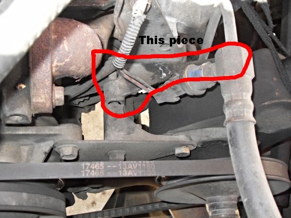

i apologyze for not posting a picture but at the time i didnt realize that it wouln't let me do it due to the size of the pic.
here they are, i just post them on photobucket.
by the way, thanks for all the replies.
this picture you can actually see where its broken.
havent had any luck finding it, even called the dealership and said they dont make it. hopefully you guys can help me out.

I may be wrong but the second picture looks like the engine mount?

Its definitely the motormount in the second pic. $16 at Autozone. 20 minutes to change. First pic looks like the power steering pump bracket. I see 2 parts in 2 pics.

It's the power steering bracket plate. Go to a junk yard. No clue why u circled the motor mount in the second pic mi see the broken power steering pump plate to the left of the circle

Because the motor mount is in severe need of replacement too before it starts taking out other things like the trans mount if it hasn't already. I would imagine that motor slams around a good bit when he takes off. Me thinks it may have helped with breaking the power steering bracket
