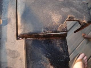

Posts: 10,104
Well I started revamping the A/C and I actually took a bunch of pics because I found my gf's camera in the back of the seat in the saddle bag. It has been lost since last August when we went wheeling at Beasley in North Georgia.
How I began with all the parts and what not:
The lower part of the housing with the thermostat still in:
The top part of the housing with a crack in it:

Three years later and I finally get around to finishing this. I just ordered a new condenser so this thread may not be useless.
I ordered the new condenser from jeepair.com for $149.99. Shipping was $15 so not too bad. One thing I need to do is take my hoses off in the engine bay and make sure they are clean and free of debris. I should probably buy some more A/C flush and do that again.
I'll post pics and actually update this in a week or so. A major force behind this project is my wife who I've been telling I would do this one fix for her.
I posted up some pics of the cracked housing. Well I fixed that with JB weld back in '10 and also wrapped the hoses to the evaporator in insulation.
