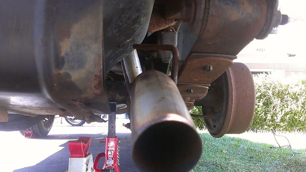

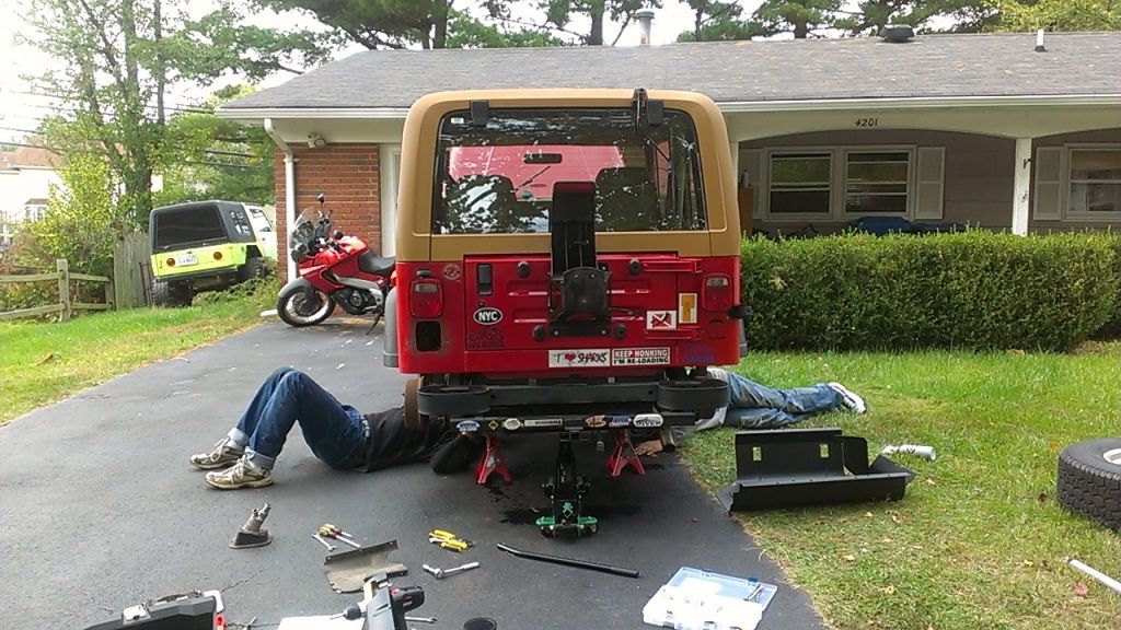

All right! Busy weekend. I did more cleaning and de-rusting. My buddy came over today to help me replace the skid plate under the gas tank with the heavier duty one by warn. Everything went off without a hitch, a couple of pictures are included. We had a tough time getting the hardware from lowes- they barely carried any grade 8 stuff at our local one. Noted for next time.
One thing I did notice, there was a u-bolt attached to a mount around the tail pipe that I think was supposed to be bolted to the body. it wasn't, was just dangling. Also, there was a metal bar welded to the tailpipe that had it braced against the gas tank. I couldn't find any lit on why it should have been there except to eventually poke a hole in the poly and start a gasoline fire on the highway. Just for the record, I got down there with the grinder to cut the damn thing off. Thanks for the confidence; no explosions.
Here we are both laying under the damn thing:
And the weird piece of metal I cut off.
I still need a torx bolt to pull the track bar- once that's off I'm probably going to replace the tailpipe with a simpler + straighter configuration.

That's the exhaust hanger you cut off. There is another one up higher and a rubber snubber to hold them together and isolate engine vibrations.

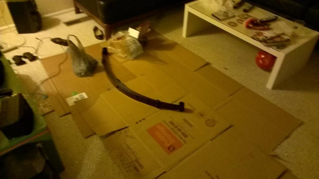

Springs arrive, I set up a floor in the living room, installed the busings, and set up the shackles. My approach was to have to do as few steps outside as possible.
My girlfriend helped wrench all the bushings together, she's too good to me:
Then my housemate and I got to work on shocks the next morning.
My phone is dead, so I haven't taken pictures after I got the springs on but the situation got dire. All the springs are on, and the bolts are torqued. I broke two hard brakelines by accident, but they needed to be replaced anyway. The rust was pretty rough.

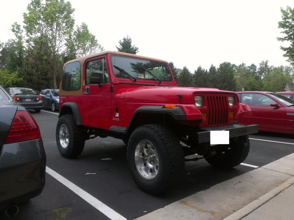

Just wanted to post an updated picture. Have done lots of work... brakes and some fluids. Got rid of the 31s for 33s on 18s and I pulled out the body lift. That was the easiest job I've done so far! Only took 2 hours with all new hardware and body mounts
Unfortunately, Carly Rae is going to have to go in the classifieds section. It's been a lot of fun, but I've hit a point where it's time to upgrade to something family friendly. In a few years when there's room in the garage, I'll pick up another- but I'm going to miss my low mileage YJ.
