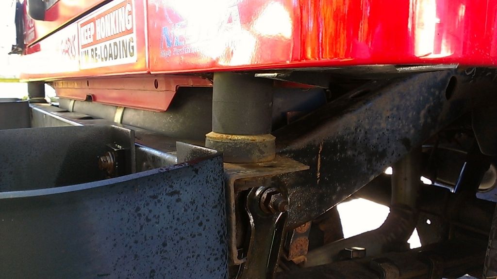

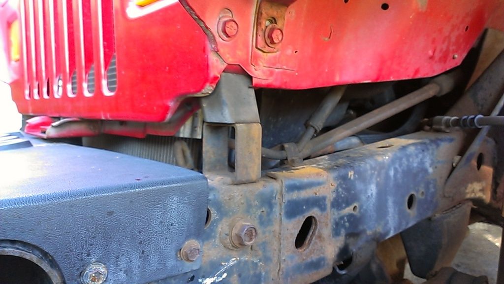

Right on! Most of the components are en route, we'll see where I stand next week. In the mean time, soaking the bolts for the tank skid and the shocks because I know I can swap those out painlessly. I'm also going to investigate the 15->20 tank mod and see if the PO had it done.
When I re-do the springs I also want to pull out the BL... this is the front:
and the rear
Will do some research on how to properly pull it and get back to the stock body spacing. 3.5" springs and 1/2" of shackle will be plenty for my 31s.
That bracket up front is welded on, so I assume I'll be cutting it off with ye ol' angle grinder... sweet!
i95yj is offline
