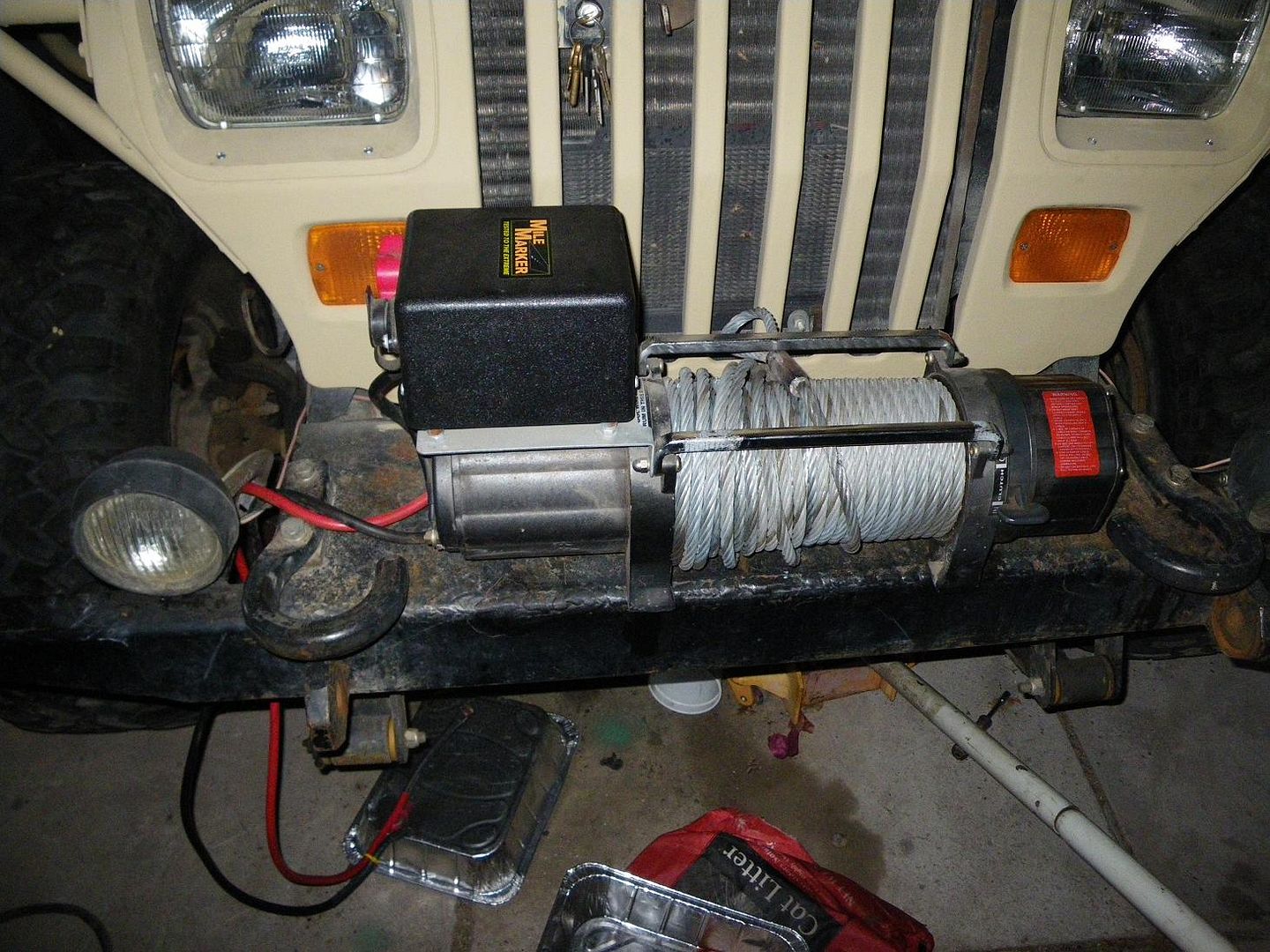

Front tow hooks from chevy/gmc pickups have the same mounting hole pattern as a YJ.
not the best picture.
Nice one, I wondered about those hooks but haven't had a Chev/GMC with those in out local yard for awhile. They came from the mid 80's-90's models?
Yes. The holes are the exact right spacing but do need to be drilled bigger because there are threaded in the hooks.
They are perfect for looping on a tow strap.
These were on my '88 GMC. I imagine that the were available on the GM 4wd trucks from 88 and up?
I like those much better than the ones on my YJ now. I always seem to get a sleeve or pantleg caught in the YJs hooks. My wife gets mad at me everytime I come in the house with new rips and tears. Then I have to and make up.
