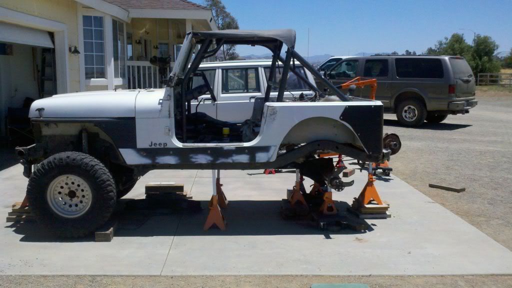

what im starting with

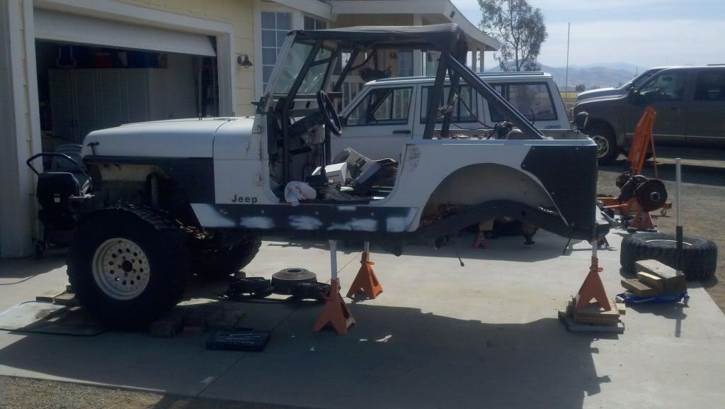

91 YJ R.E. 2.5" springs, dana 30 w/ lockright, dana 44 w/ ox locker both have 4.88 gears.
the plan
dana 60
14 bolt
5.38s
rear 4 link w/ stock xj coils
xj springs flipped up front(for now)
shooting for 108" wheelbase
39-42" tires
22-24" belly hight
skid flat with the frame

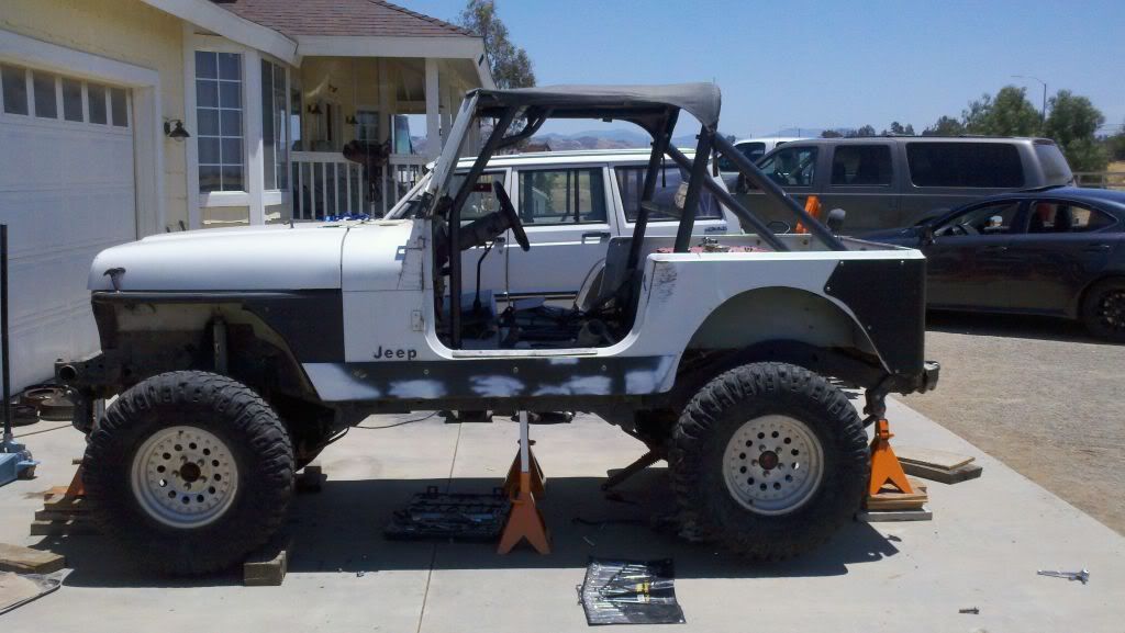

put it on jacks

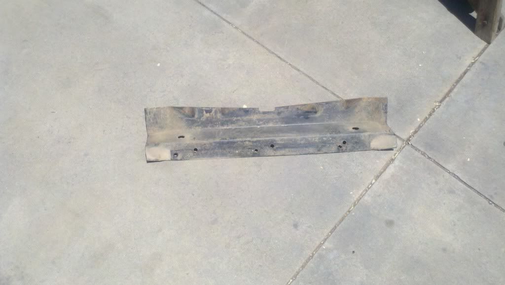

transmission crossmember

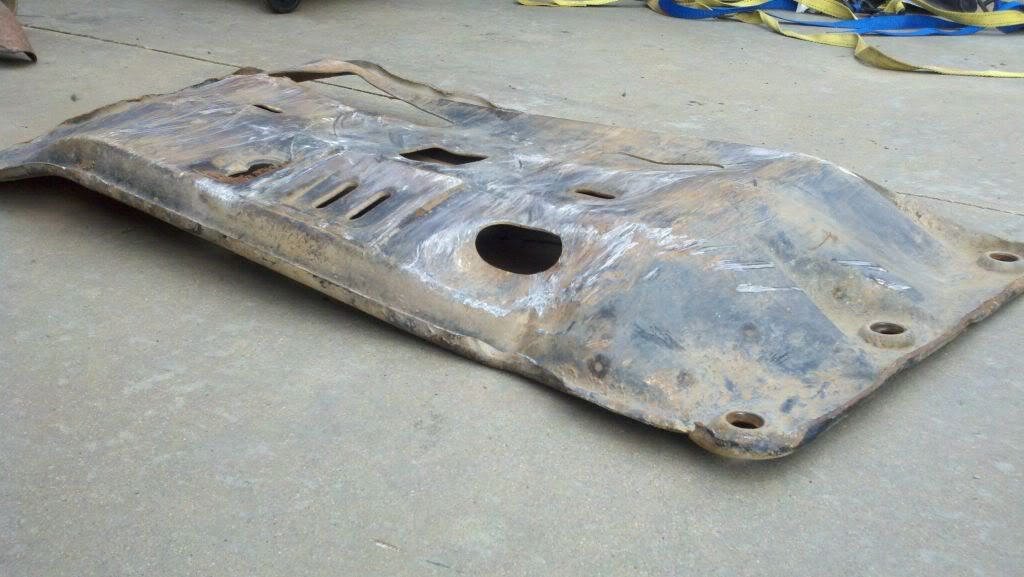

my stock skid was beat to crap

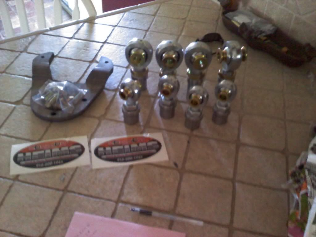

some heims and disc brake brackets
brakets on

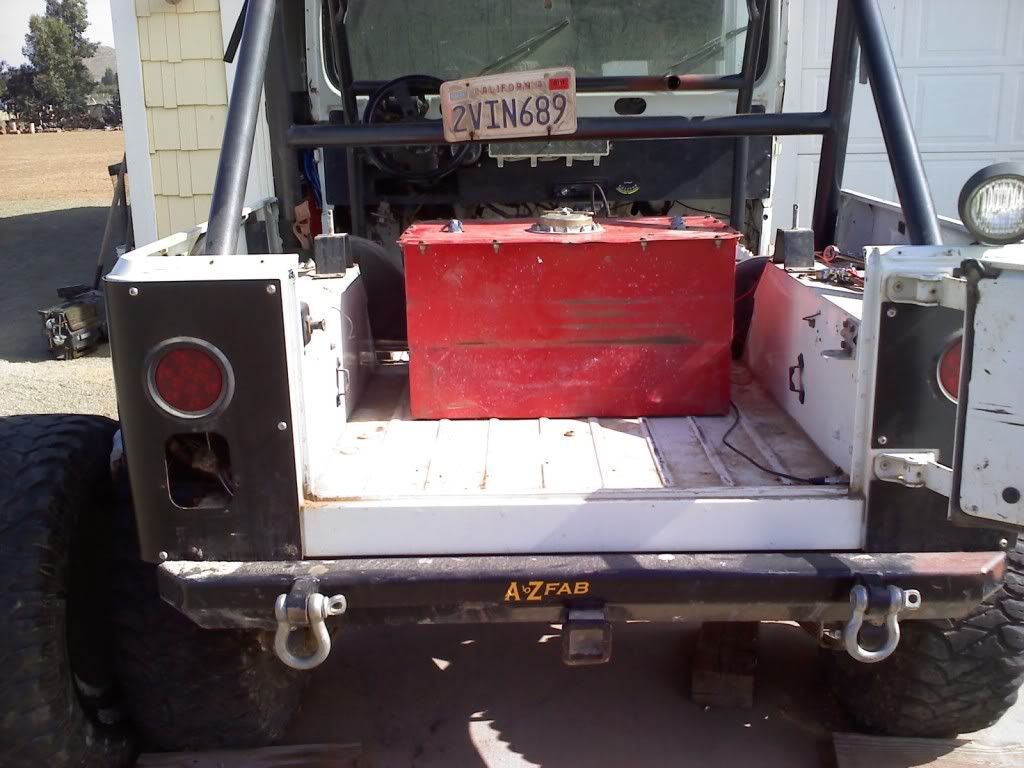

picked up a 22 gal. fuel cell for $200

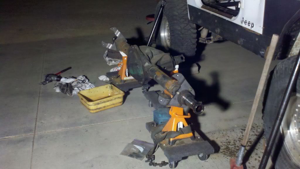

good bye leaf springs
14 bolt in and around 7" stretch
im working on the 4 link now. I'll post up some pics when its done

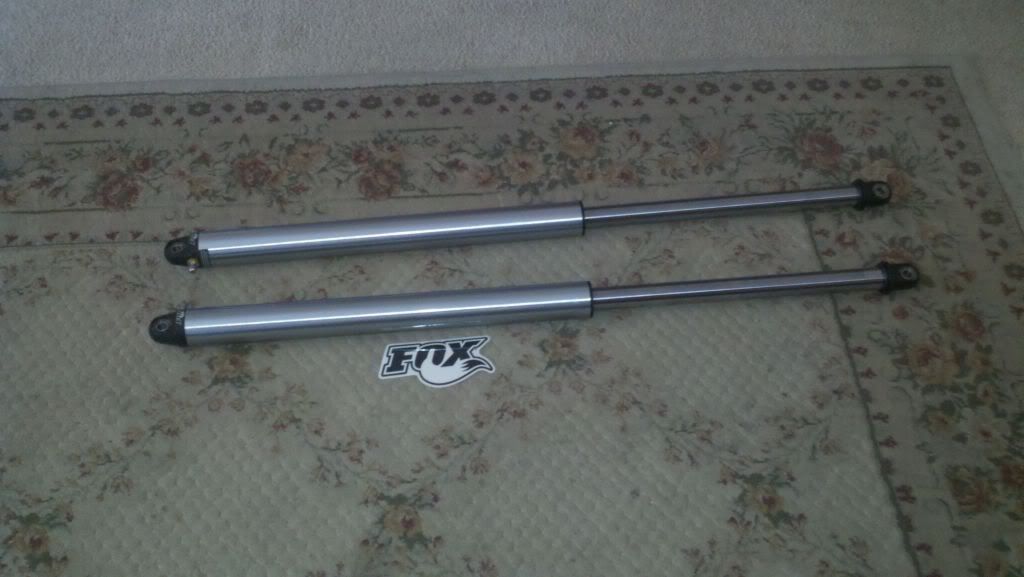

well i picked up 2 16" fox air shocks today for $450

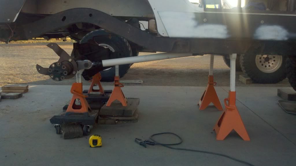

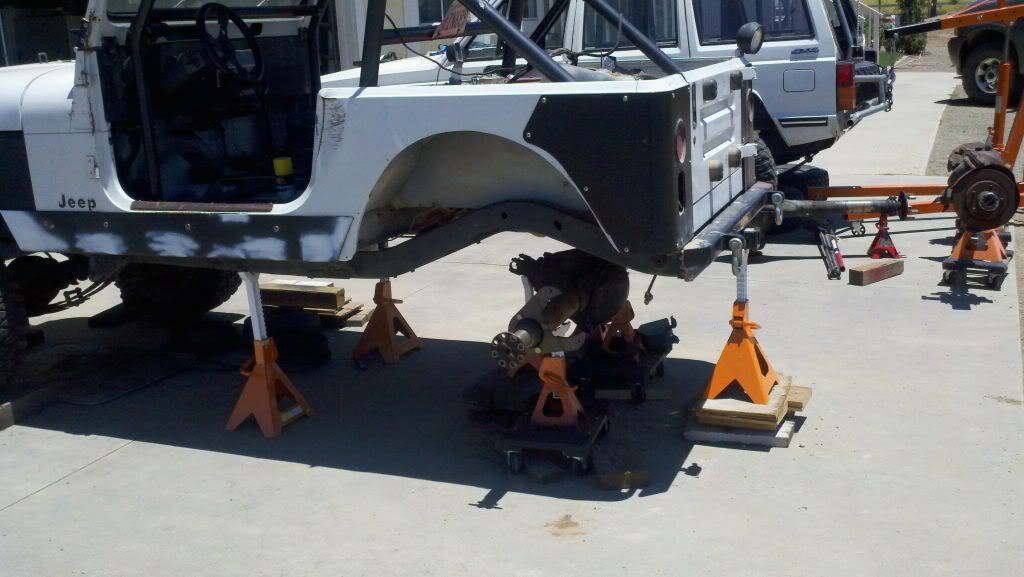

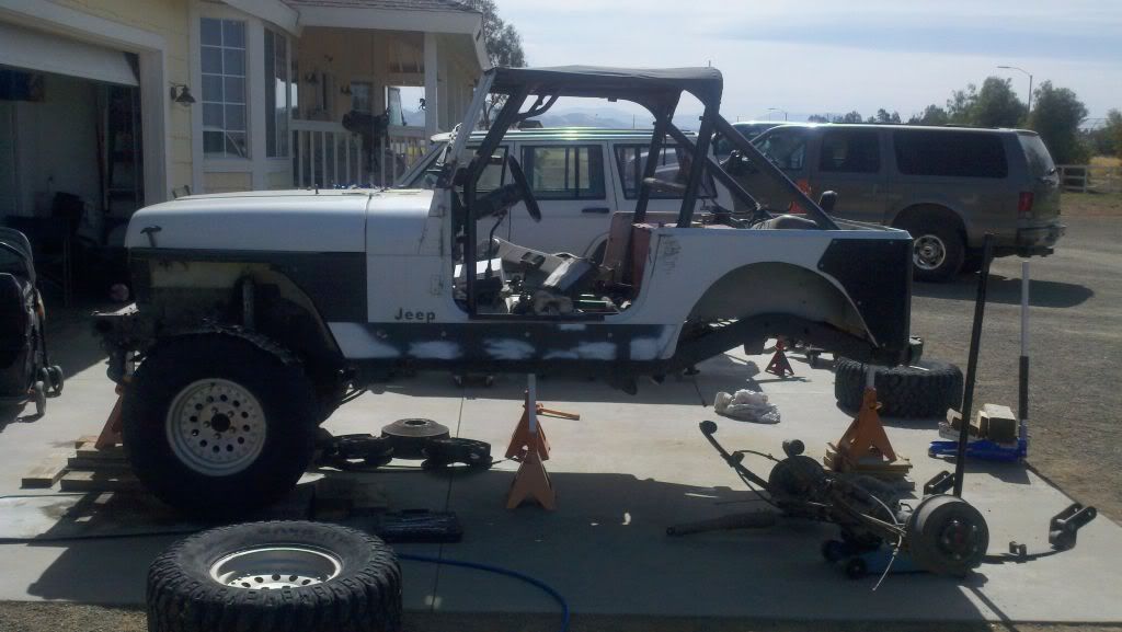

made some progress

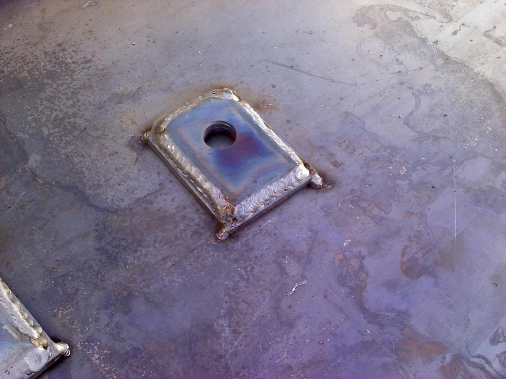

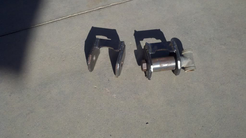

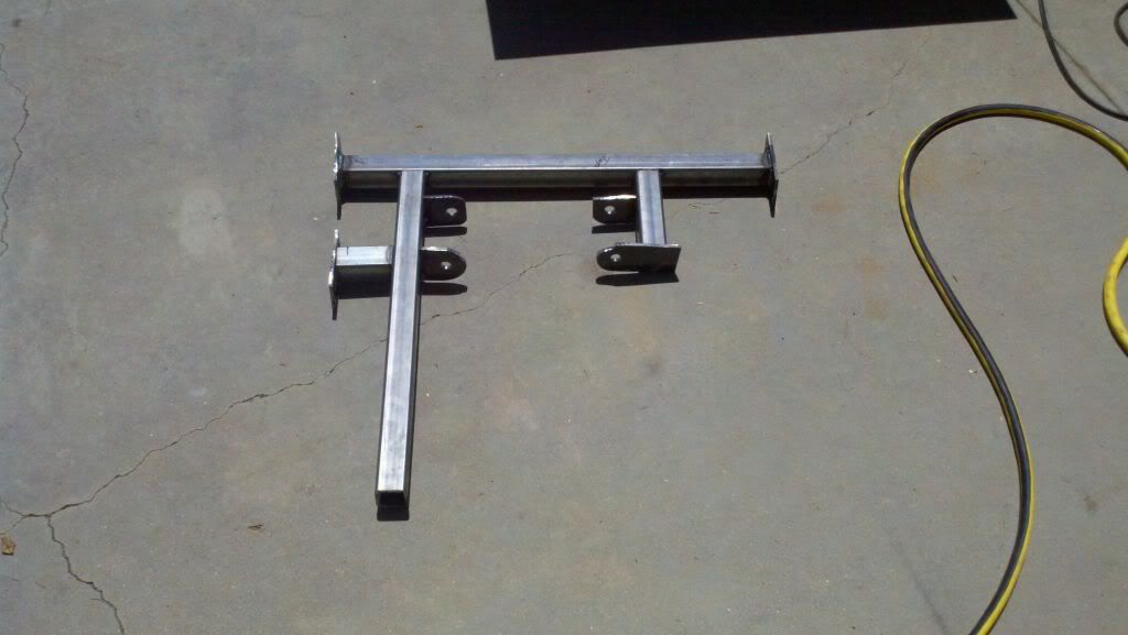

lower link mounts on the frame end. there 3/16 laminated with 3/16
upper link mount this will be sleeved with 1.5 .120 wall and gusseted all to hell and tied into the frame
mock up link
the stock crossmember is in the way of the uppers on the axle end, so i cut it off
but first i build a new one out off 1.5 .120 wall

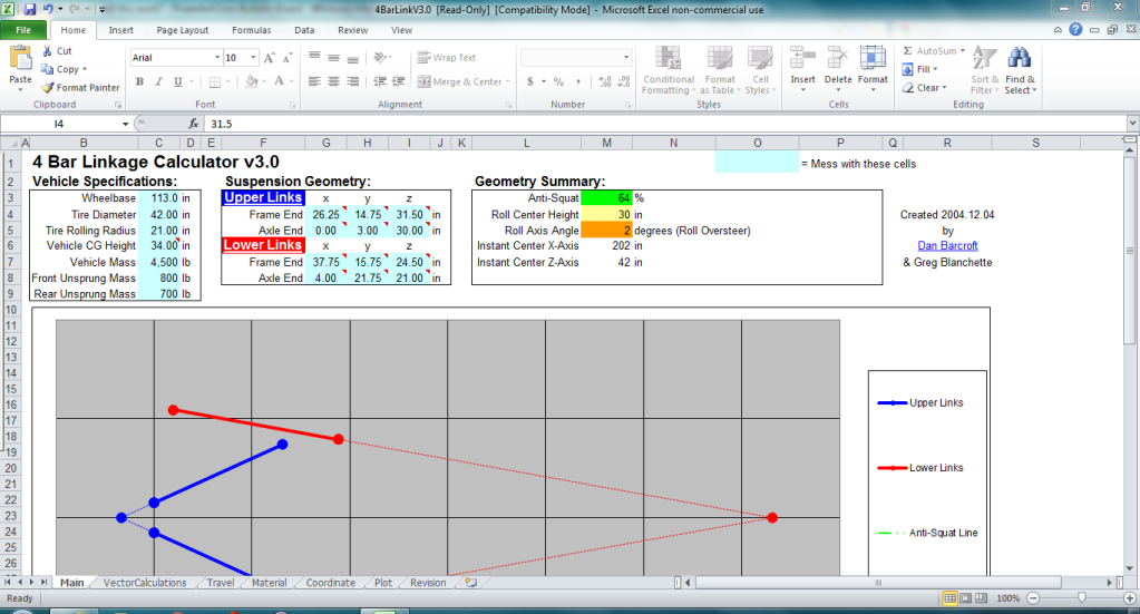

4 link numbers

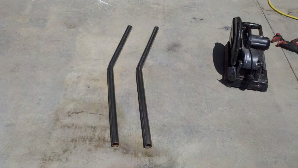

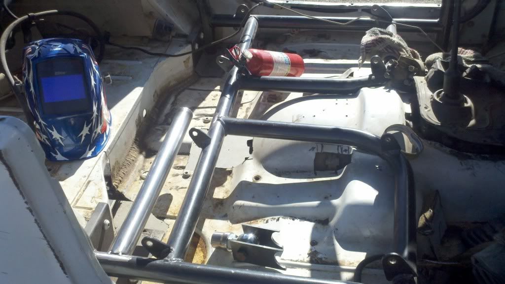

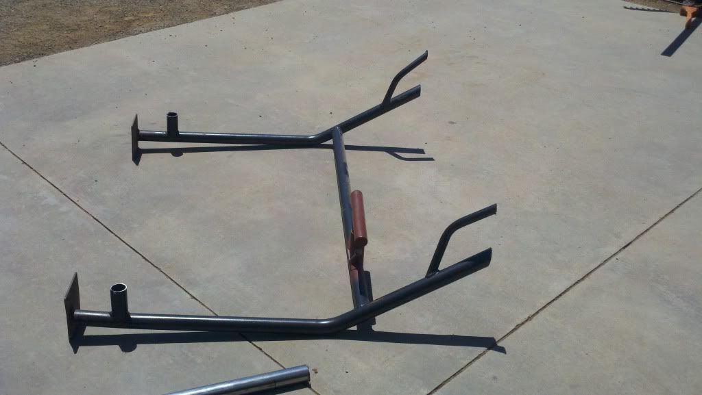

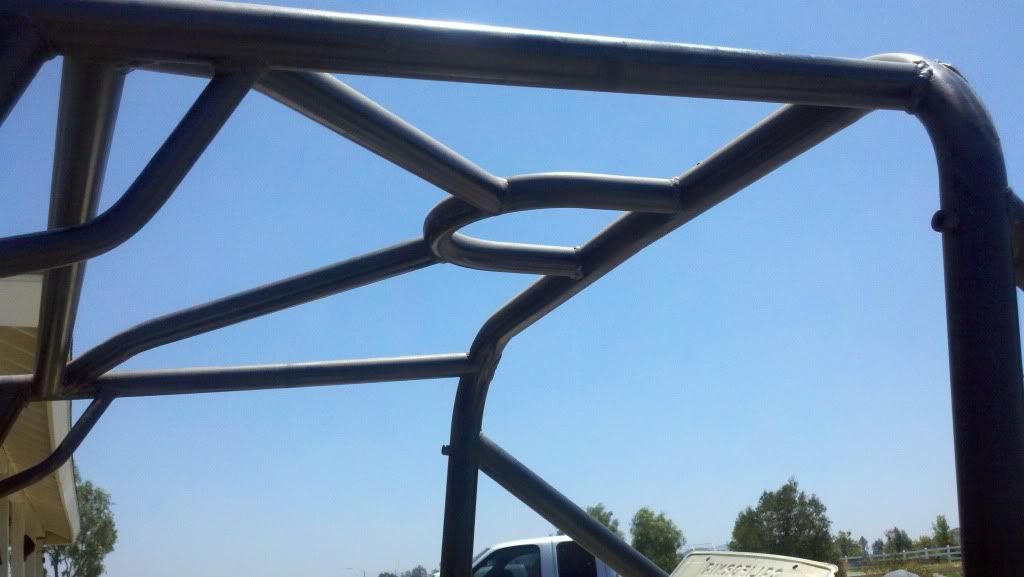

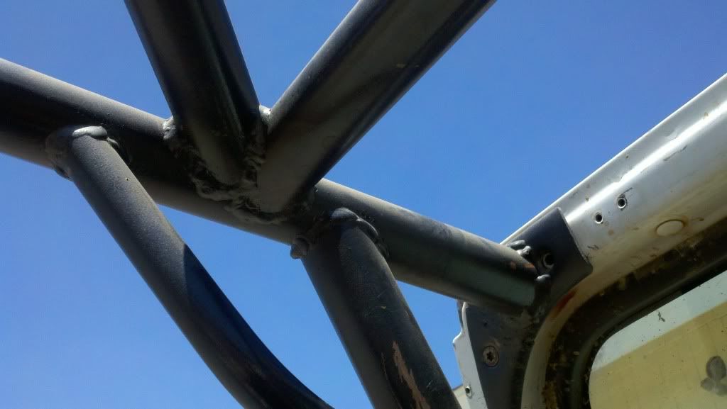

Since we were waiting on a couple parts I finally talked my brother into re-doing his cage. He had a cage kit that didn't fit to well and had dead tubes everywhere. It works fine in a rockcrawler but I wouldn't trust in a roll at speed.
Old cage
Cut out the old cage

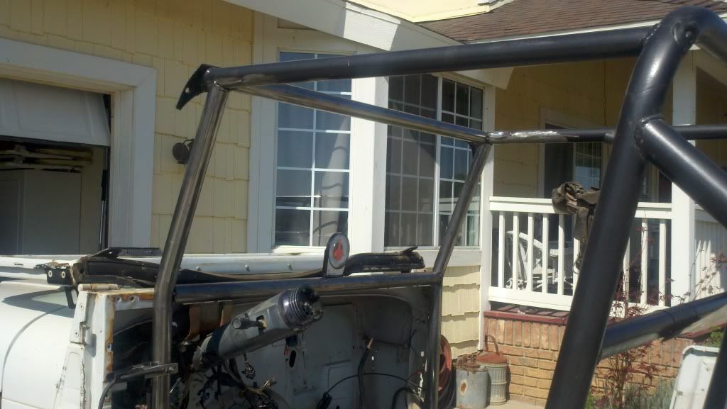

Bent the A pillar 20 degrees
A pillar mocked up
Got the dash bar and A pillar tube going across in

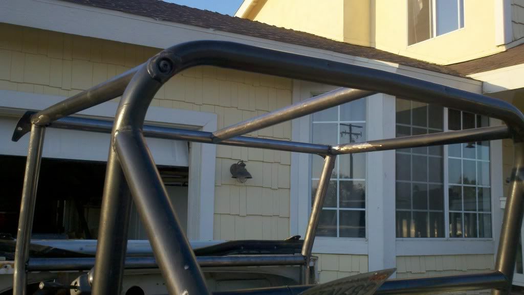

Started to add some triangulation in the roof. We still need to add a couple tubes
DualPurposeXJ is offline
post #15 of 18 Old 08-14-2011, 04:43 PM
hrt4me
Location: Dallas
Posts: 327
that improved cage looks good
