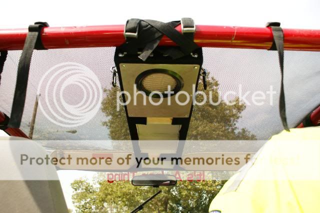

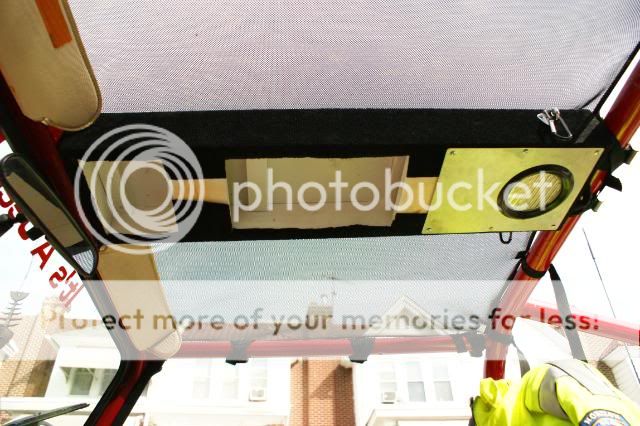

Overhead Center Console
I also started an overhead console to accomodate my CB, switch panel, power inverter, overhead light, and 12 volt charging ports. I like the fact that all of this equipment is high up and out of harm's way from mud and water. It is constructed from 3/4" laminated plywood reinforced with fiberglass. I covered the entire box with water-resistant poly black fabric. The securment to the vehicle is made possible by durable straps holding it to the center hoop and a bracket to hold it to the windshield frame. Pretty rock solid.
I finished the first plate that includes the overhead light, a 4" 80 LED light, super bright. I want to get this done......too useful.
More to follow.......

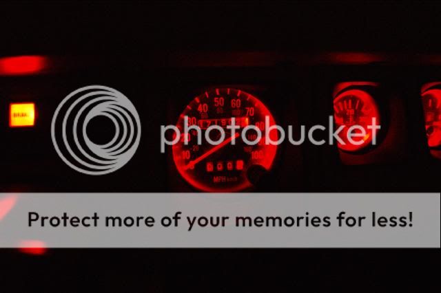

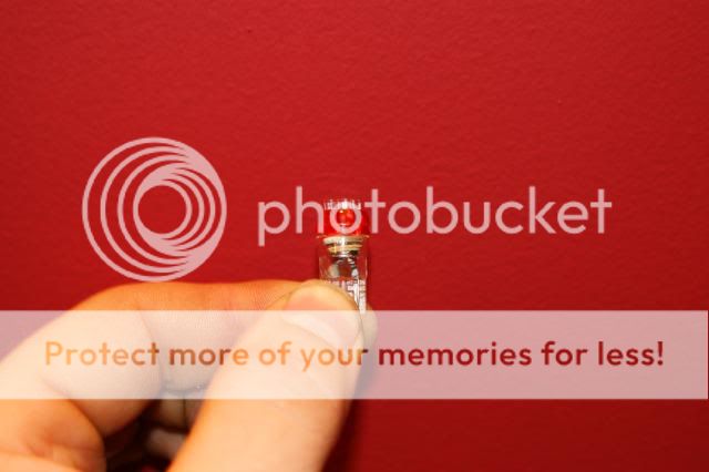

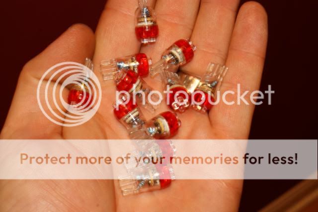

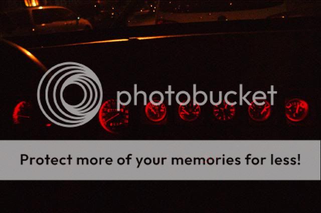

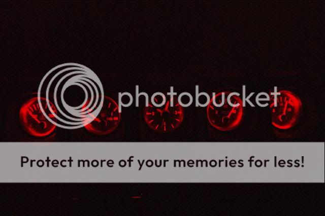

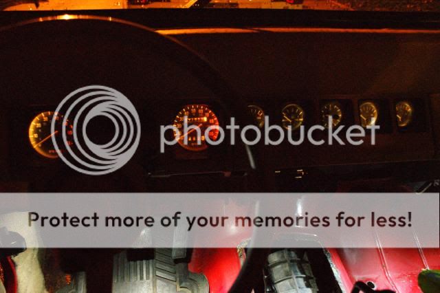

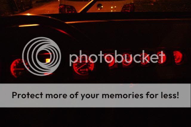

LED Dash Conversion
So the postman left a gift in the mailbox......

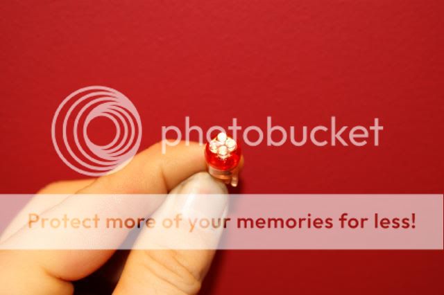

I wanted to go with red backlighting for the gauges. I do beleive that red is easier on the eyes at night, plus the Buckit is red. (Now, I'm not one of those people who thinks that everything should be monochromatic to the color of the Jeep. From the tacky vinyl seat covers to the $34.95 anodized billet aluminum oil cap. Crap....all crap. Functionallity prevails over aesthics...always.)
There are 11 needed in total to complete the dash. This include 1 for the climate controls.
The bulbs are made to fit the 197 base and are equipted with 4 LEDS at the 90 degree viewing angle.
.....the before.
...the after.
It's hard to take good pictures in low light, so I apologize for the poopiness of the above photos. All in all, I like the new look. Well worth the time and effort. This is a very easy mod to do, it only took me about an hour to complete.
