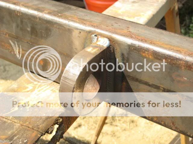

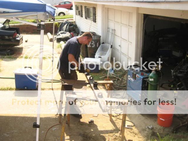

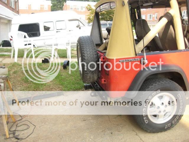

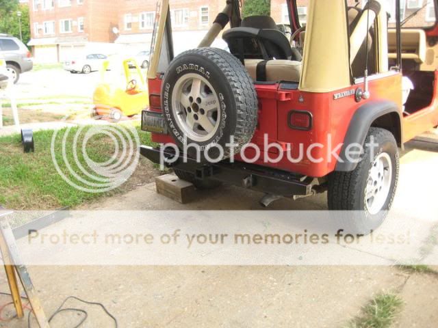

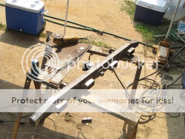

Rear Shackle Bumper Build
Well a trip to the Kommandant's shop one sunny afternoon, showed the birth of a new shackel bumper for the Buckit. Very sturdy and rugged. Plus now the ability to use my little 4' X 8' Trailer.
Soon, it'll be time to build the front bumper.

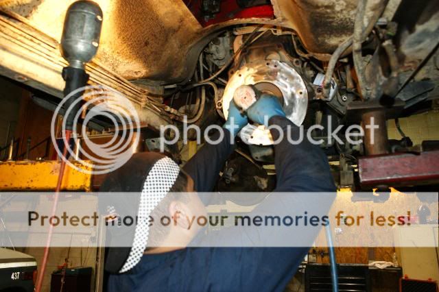

After getting the Buckit on the lift we started removing the belly pan. The typical problems ensued with the nutserts either spinning or bolts being broke off in the frame rails.
The skid plate was pretty much destroyed as two of the mounting holes were pulled through. This was most certinally an issue that needed to be addressed.
It is certin that repairs have been done before.
After the skid was removed and the trans supported, the driveshafts were unbolted and removed. At this time we also noticed that the track bar mount on the axle was completly destroyed. More reason to lose the bar!

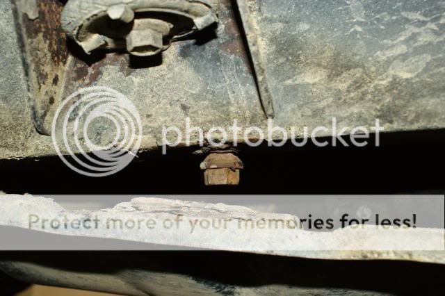

I think I might need body bushings......
No need to unbolt anything here........it just pulled right through.

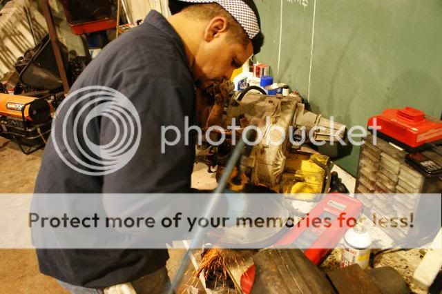

The exhaust system was in need of repair as well. There were several breaks in the piping. The cat and muffler were...well, crap!
The trans and the transfer case have been removed as well as the exhaust system.
The new (un-fubared) trans and transfer case. This was pulled out of a '93 with fuel injection. It appeared that the Trans has been rebuilt recently. The T/C is a NP231 J. Honestly, for $600.00 I'll take the gamble on a rebuilt trans.

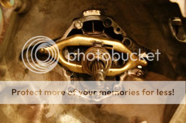

.....on to the installation of the trans.

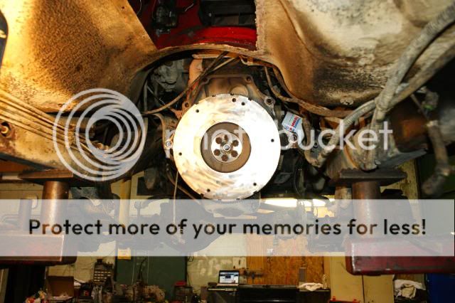

Giving the flywheel a little freshing up. The clutch that came out was in fairly decent condition and still had alot of life left. However when everything is out and you're in here, replace what you can.
Flywheel going in. Also in regards to the outer edge of flywheel....this is the area that the crank sensor uses to pick up signals. Make sure it is clean and rust free.

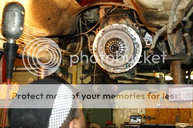

Clutch disc and pressure plate going in. (Bouns Points if anyone can tell what is wrong with the above picture, and why it caused us a buttload of problems later.....)

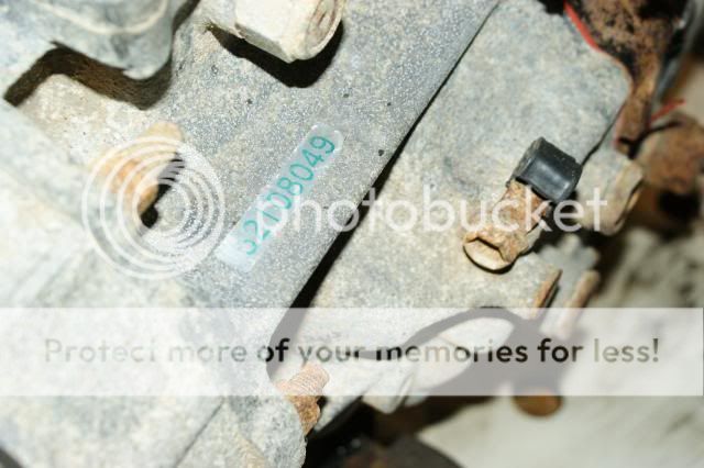

Does anyone know what this number is. First number is 3. It is not on the trans that was removed. I beleive that it is a part number. I know that GM uses 8-digit part numbers similar to this. Ideas?

Looks like you left the alignment tool in place. That's ok, I forgot to install the rear main seal before I mounted the transmission when I rebuilt the engine
