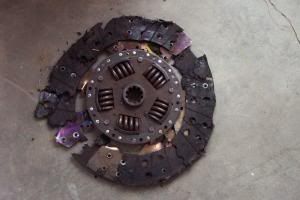

It sounds like a blown clutch disc. here is what mine looked like when I blew one up a few years ago (I-6 and the pug-crap tranny). All the rivets to the center hub sheared and the jeep was dead.
