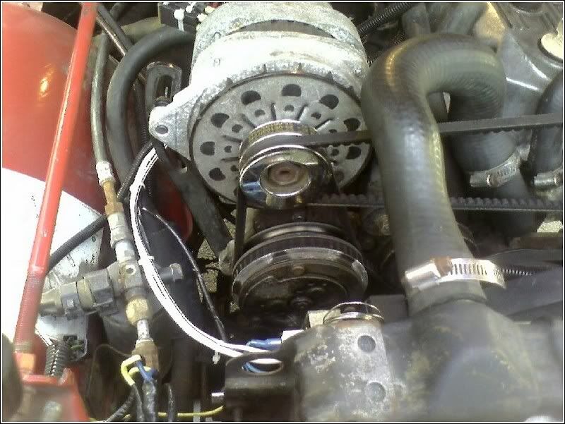

Does your setup look like this...besides a different looking alternator and chrome pulley?

That's how mine is setup except for the double pulley on the alt. That's for your OBA right Coupe?

Here is what mine looks like. But I only have one belt on the alternator.
There are other pics in my gallery if ya would like to see some.
