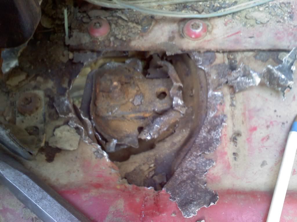

Are you saving your tub? If not, just hack into the floor around the spinning bolt. The two that are frozen, I would PB several times a day for a week. If you drill a hole in a strategic area through the body you can spray the end of the bolt. Some bolts are just too far gone though. Sometimes you can overtighten them and thus snap the head off. You CAN grind them off, but it's a royal pain, I just did mine. Or use a cutting torch, but watch for the fuel lines theyre right under the driver's seat. If you don't have access to that (like me) you can take your time with the grinder, or hack away at the floor around the bolt. Here's what I did to one of mine because I didn't care about my tub, and the bolt wouldn't move

You have no choice for the spinning one. You are going to have to cut into the tub above the body mount and tack weld a new nut for the mount.
