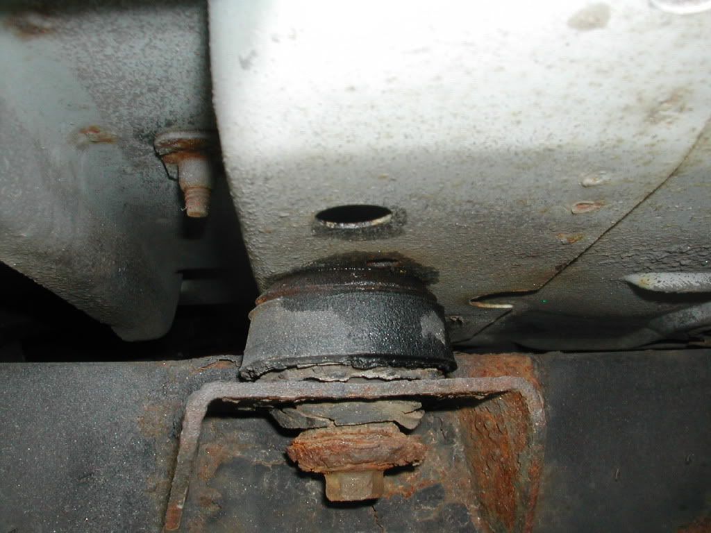

I'm in the process of soaking my body mount bolts with Liquid Wrench, and I'm able to get to the 2nd pair (In front of the driver and passenger seat) without drilling. I can snap a picture in a minute.

Here's pictures. As you can see the oil is coming down around the mount and starting to work its magic.
Driver side:
Passenger side:
