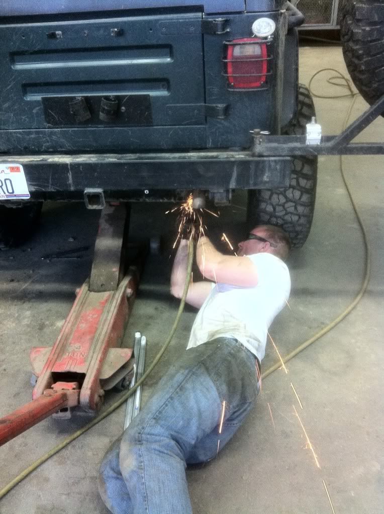

I went with the PUREJEEP gas tank skid plate. There a dimple in the bottom like the factory plate for the fuel pump well.
