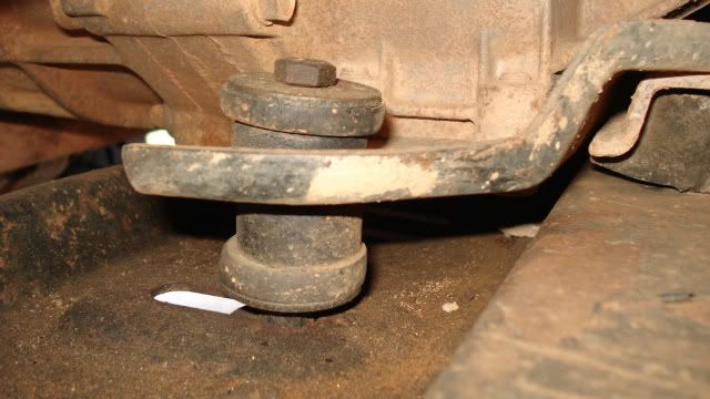

Here is the thread I wrote about replacing the torque arm stud and tranny mount:
http://www.jeepforum.com/forum/f12/h...ement-1075968/
For easy reference, the torque arm stud is here:
http://www.fyurl.com/rr.php?site=www...px?partID=8365
Torque Arm Bushings are here:
Energy Suspension 2-1101G - Energy Suspension Transmission Torq Arm Set in Black for 73-95 Jeep® CJ & Wrangler YJ - Quadratec
...and here is how it all goes together (last pic from thread)

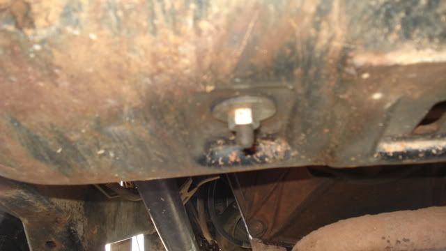

Bob the jeep is looking good. Here's a pic of what I did with my stabilizer bushing. Pretty much exactly what you're doing but I didn't put a washer in between the top of the skid plate and the nut. I need to do that come to think of it. Also, I threw away my pass. side mirror because it was useless.
