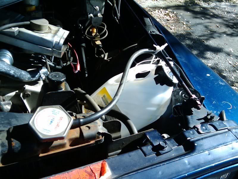

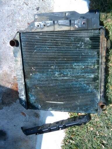

The next big problem that came up was the overheating. i first didnt notice the overheating cause my gauge needle was bent to the left making it seem like the temp was fine. well once the smoke started to arise while at idle i knew i had a problem.
It looked like a few of my hoses were bad and probably a bad thermostat so i replaced every hose except one and put a brand new thermostat.
well a couple days later i got off work only to find a big puddle of ccolant under the jeep. the lower hose went bad (the hose i didnt replace) so i replaced that one.
i was still loosing coolant somehow. there was a tiny puddle under the jeep after every drive and some on my leaf springs. Not being the brightest in the bunch i also finally noticed i didnt have a coolant reservoir bottle. i did this for a temporary fix:
yup its a canola bottle.
i now have a coolant bottle from summit racing. ill get a pic up later, dont have one on hand.
so i thought the problem was solved but i was wrong as i found out on the trail with contra and clacker and dalton. my radiator was leaking so i replaced it with a all aluminum performance radiator with extra wide tubes. also got a new cap and changed the thermostat to a 180
old crap
New Bling
