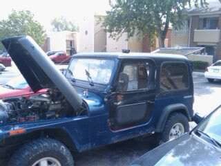

Its an 87 YJ that i bought off a guy who had literally just had it a week and figured out he didnt have the money or patience to fix everything that was needed. Before that it sat in a barn on a ranch. it had 85,000 miles on it and i got it for a steal.

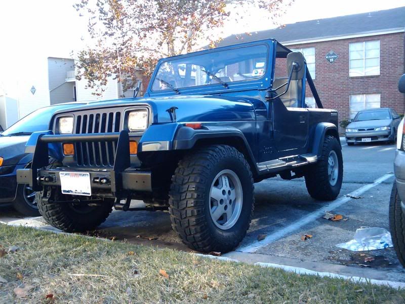

This is what it looked like a week after i got it with tires supplied from my old CJ ;D
I also rebuilt the Carb and found out the Computer is pretty much fried which affects the carb and distributor.
Unfortunately after these pics I found out i had a hole in my gas tank 3/4 of the way up. I did a quick patch up with a bar of soap and ordered a brand new poly-urethane gas tank.  it took a month to get it so i could only keep a 1/4 tank in the jeep.

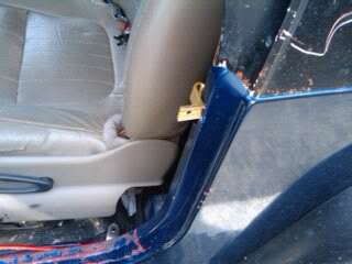

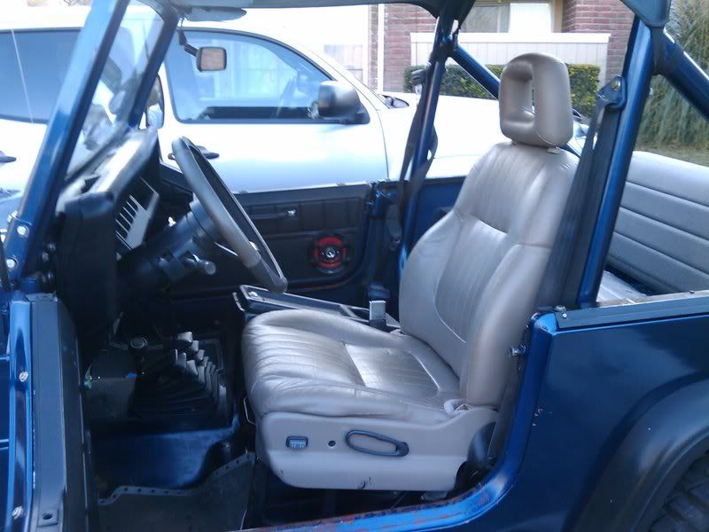

My seats were torn up pretty bad and i didnt have money for brand new ones so i hit up the junk yard and pulled out seats from a 97 grand prix. they sit higher than the stock seats but i like it. the passenger seat didnt bolt right in so i have to build an adapter for the bracket. ive just been lazy so it hasnt been done yet. comfy seat though.
i also put in a new heater core the same week.

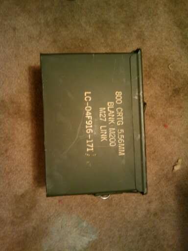

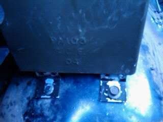

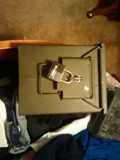

Ok so my stock center console was a big heeping peice of plastic crap that didnt lock and wobbled around. it really bothered me so i searched for a solution. this is what i ended up doing for a center console. I used a 556 ammo box i bought from army surplus.
I DRILLED 2 SMALL HOLES AND PUT A U-BOLT THROUGH THE FLIP OPENING WITH A SMALL PADLOCK.
THE FRONT BOLTED DOWN STRAIGHT TO THE TUB. IN THE REAR I HAD TO USE SOME LIFT TABS I FOUND LAYING AROUND A CONSTRUCTION AREA AT WORK.
THIS WAS THE FINAL RESULT
OH AND WHEN I DID THIS I ALSO ADDED SOME OFFROAD LIGHTS ON MY BUMPER

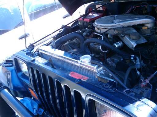

The next big problem that came up was the overheating. i first didnt notice the overheating cause my gauge needle was bent to the left making it seem like the temp was fine. well once the smoke started to arise while at idle i knew i had a problem.
It looked like a few of my hoses were bad and probably a bad thermostat so i replaced every hose except one and put a brand new thermostat.
well a couple days later i got off work only to find a big puddle of ccolant under the jeep. the lower hose went bad (the hose i didnt replace) so i replaced that one.
i was still loosing coolant somehow. there was a tiny puddle under the jeep after every drive and some on my leaf springs. Not being the brightest in the bunch i also finally noticed i didnt have a coolant reservoir bottle. i did this for a temporary fix:
yup its a canola bottle.
i now have a coolant bottle from summit racing. ill get a pic up later, dont have one on hand.

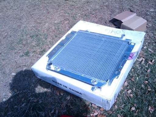

so i thought the problem was solved but i was wrong as i found out on the trail with contra and clacker and dalton. my radiator was leaking so i replaced it with a all aluminum performance radiator with extra wide tubes. also got a new cap and changed the thermostat to a 180
old crap
New Bling

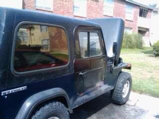

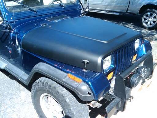

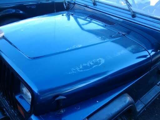

I also painted my Hood, Doors, and Tailgate black. the paint was coming off pretty bad so i sanded it down and rattle canned it black.
BEFORE:
AFTER:

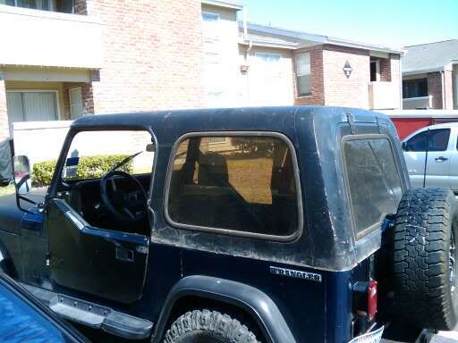

So i thought it would be a good idea to invest in a top. ive never had a top that covered everything. ive only had bikini tops. i love em but when it rains or gets cold it sux. so i bought this in hondo for only 400, i think i got a good deal. its off a Cj7 and needs some adjusting to fit right and maybe some paint or spray on bedliner ;D
oh and i almost forgot the sticker. love stickers, especially this one.

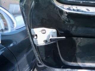

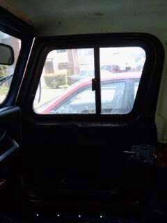

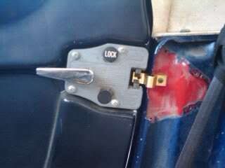

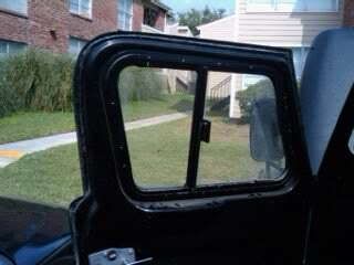

Ok today has been a pretty productive day so far. I invested in some doors. the doors are from a really old cj pre82 i believe. there is a gap between the door and body but i think some thick weather stripping will take care of it. it took some ghetto fabricating to make a latch for them, but it suprisingly works. later on i will bend an apropriate piece of metal so this works a little bit better. ok well heres the pics:
oh, btw i got my stereo in (donated by contra ;D) but since my speakers were in my half doors i found another solution. i was at pepboys 4 months ago for some unknown reason and stumbled across a small speaker box that holds 2 6.5in speakers and 2 tweeters. it was on sale and there was like 2 left so i bought it not even knowing what i would use it for. well it convienently sits between the front seats and rear seat now that i have a smaller center console, so now the sub can go back in. ;D

Wow, like the ammo box idea... i saw 556s on one of them, know a guy doing his with an old .50 Cal box, definitely like the concept
i actually bought the 50cal first to do this but after installation i found that it was kinda in the way of my shifter and i kept banging my elbow.

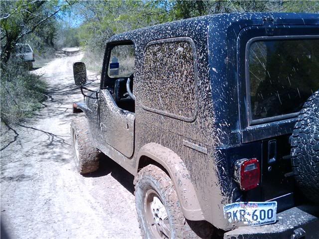

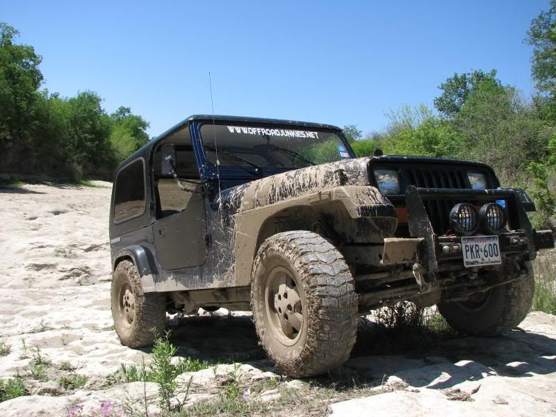

we need to get it muddy again!
Do you mean like this.
i do agree, but i definetly want to do some work first:
change tranny and t-case fluids
and rear driveshaft u joints
and maybe the axle u joints also
