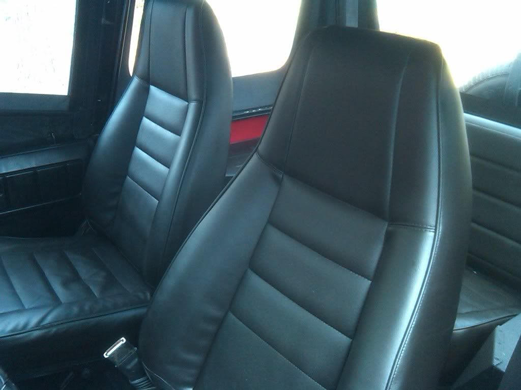

While we were waiting on the head, here is what my 14 year old son and I did to the interior. Spray dyed the seats, krylon fusion on the dash and door panels, and black bedliner rolled on the floor. Found a new in box top on Craigslist for $100.
clarkmcmp is offline
