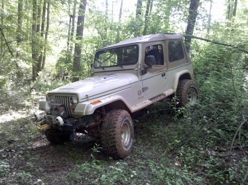

Here is mine. I can take better pictures a little closer to the jeep tomorrow if you'd like. Overall the fit was great. They won't just fall into place though, you will have to work with your doors and what not to get everything to seal right. Quality seems to be great and the only problems I have with my top are that it seems that they don't put velcro on the zipper flaps anymore, its just a flap that is sewn and you have to kind of peel it back to get to the zipper which can admittedly be a real pain in the *** sometimes. My boss has a supertop on his cj7 and his has flaps that are velcroed and can be pulled completely out of the way. I guess they changed the design though. It also it really loose when it gets hot and can be pretty loud on the highway. I have found that a shirt wedged in between the canopy and the main bow remedies that. but when its below 70 degrees it seems to shrink down and fit a lot better. Folding it down and putting it back up is really easy.
All in all I highly recommend this top if you have the coin, it is pretty expensive and spring for the tinted windows if you can they are very nice.
*edit* Oh and another problem I had with the top is that it is advertised as including everything you need to install it but when you get to the last page in the instructions you find out that the door surrounds aren't included and you have to buy those from your dealer. no biggie, i don't use them anyway, just makes the uppers harder to get off.

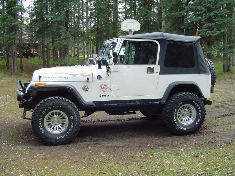

Only had mine for about a week now. Fits much better than the factory one and is quieter on the highway too.

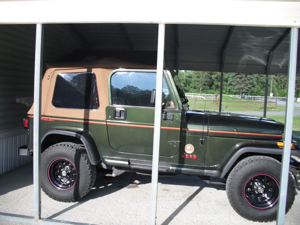

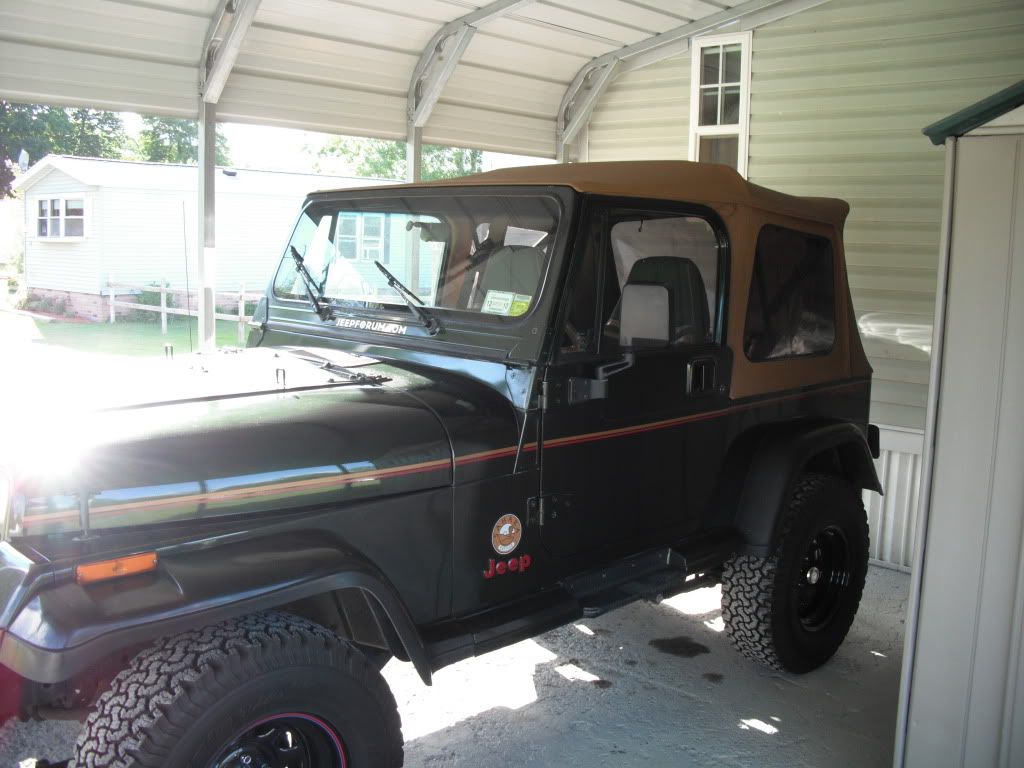

I have a Bestop Supertop and it seems to fit good, but I have a whistle from the drivers side windshield area that's driving me crazy. Very good construction. I haven't put it down yet; seems a little more complicated than my 98 Bestop Supertop. Any hints, tips or tricks would be greatly appreciated.

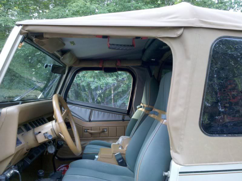

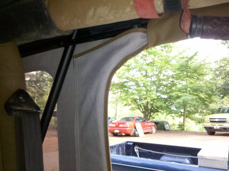

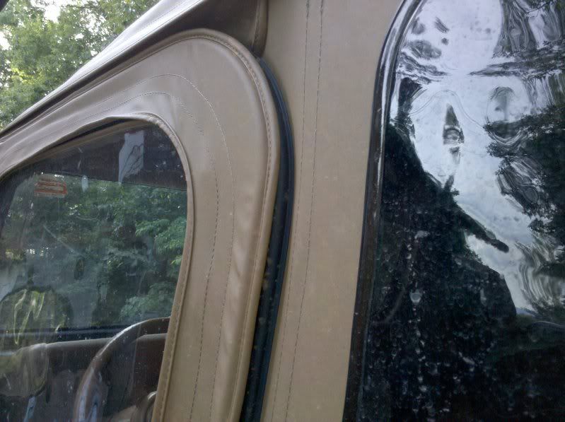

Ok here you go:
The main canopy has little velcro flaps that wrap around the metal door frame, and then the side windows velcro around it as well. The door has a soft rubber weatherstrip all the way around the edge that pushes up against the canopy and side windows. I didn't really like the way this design looks at first because the door uppers aren't really flush with the rest of the top like on a factory style. But I can say that the simplicity makes it really easy to adjust and It absolutely does not leak or flap around in the wind the way it looks like it might. It is very solid, and the look has grown on me, I think the supertops are a definite improvement on the factory style as far as looks go.
