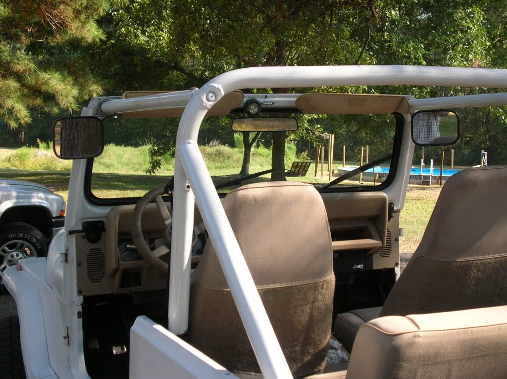

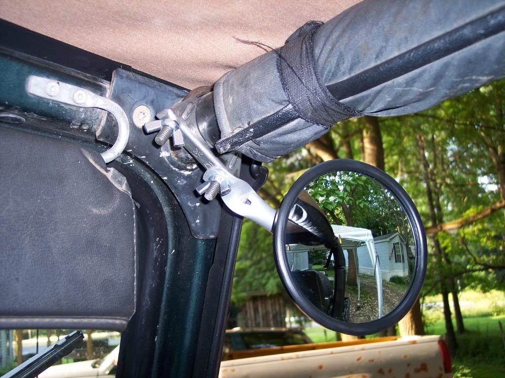

I just moved my mirrors from door pin mount to roll bar mount yesterday. I love the views from the mirrors now and they are pretty vib-free. Just a couple 1" muffler clamps around the roll bar and some home made mounting bars from " conduit. I got this idea from another Jeep Forum user that substituted wing nuts for tool-free removal and he used smaller round convex mirrors. I will be switching to those very soon as these mirrors are a little too big making them obtrusive.
Here's his (username mwater) version. Pretty smart...
Boycott shampoo! Demand the REAL poo!
