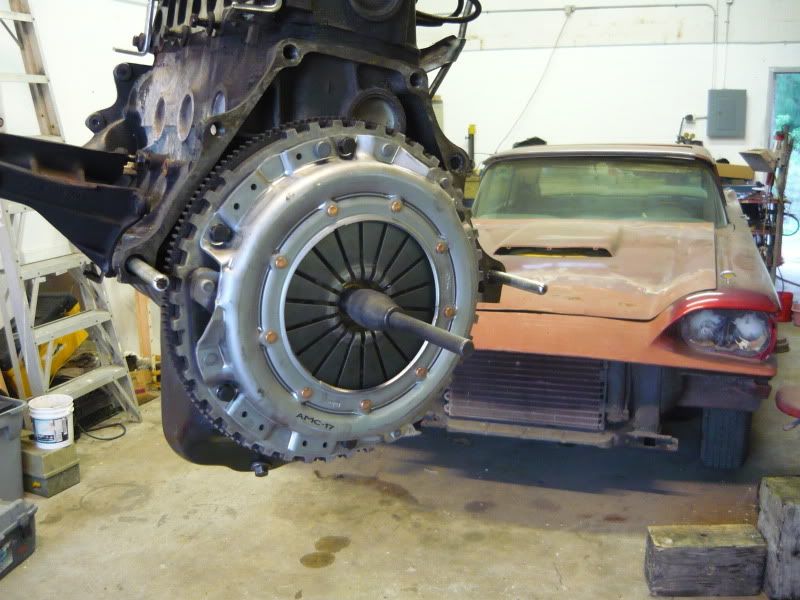

IIRC, they are 12MM X 1.25 pitch.
I just did a 2.5L motor job & used 100MM length bolts for the motor stand.
When you're done on the motor stand, chop the bolt heads off & cut a slit in the end (to use a screwdriver in) and use them for line-up pins while reinstalling the motor.
