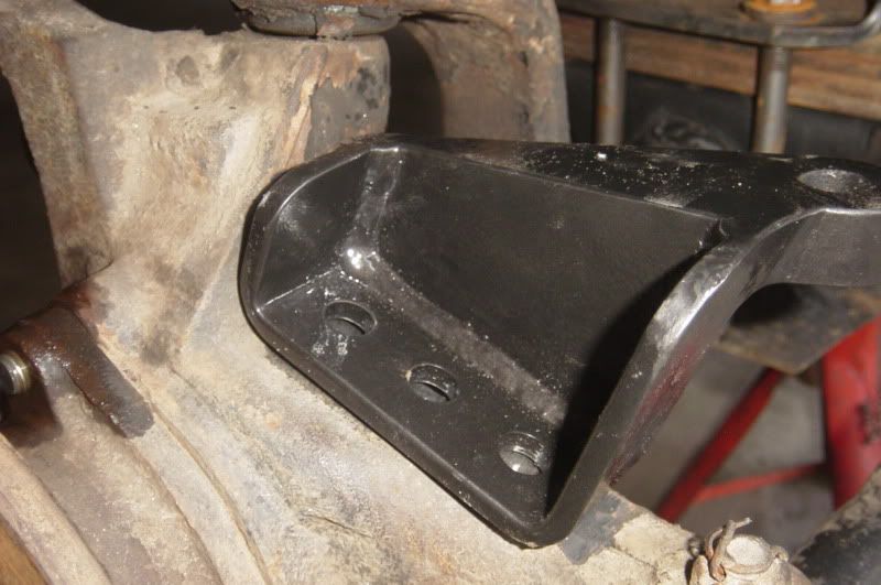

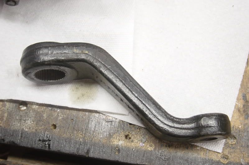

What a our your pitman arm? I currently have 4" now

This is my pitman arm. Top of page http://www.jeepforum.com/forum/f12/t...22/index3.html
You have any pics of your steering setup?
