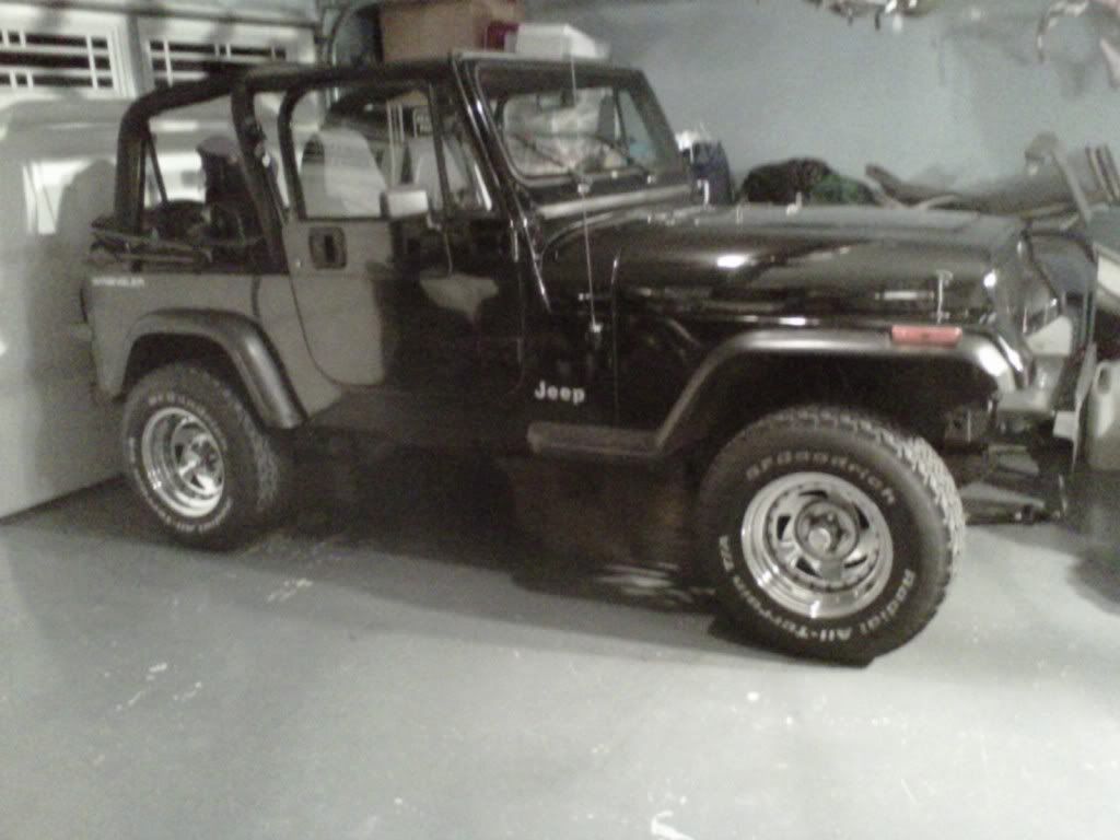

For those who are doing this, what is the angle of the drag link as compared to the tie rod? Here in this picture you can see mine is just barely positive. I know the closer the angle is to 0, the better/propper the steering response is, but my front sets about 2" lower than the rear.
