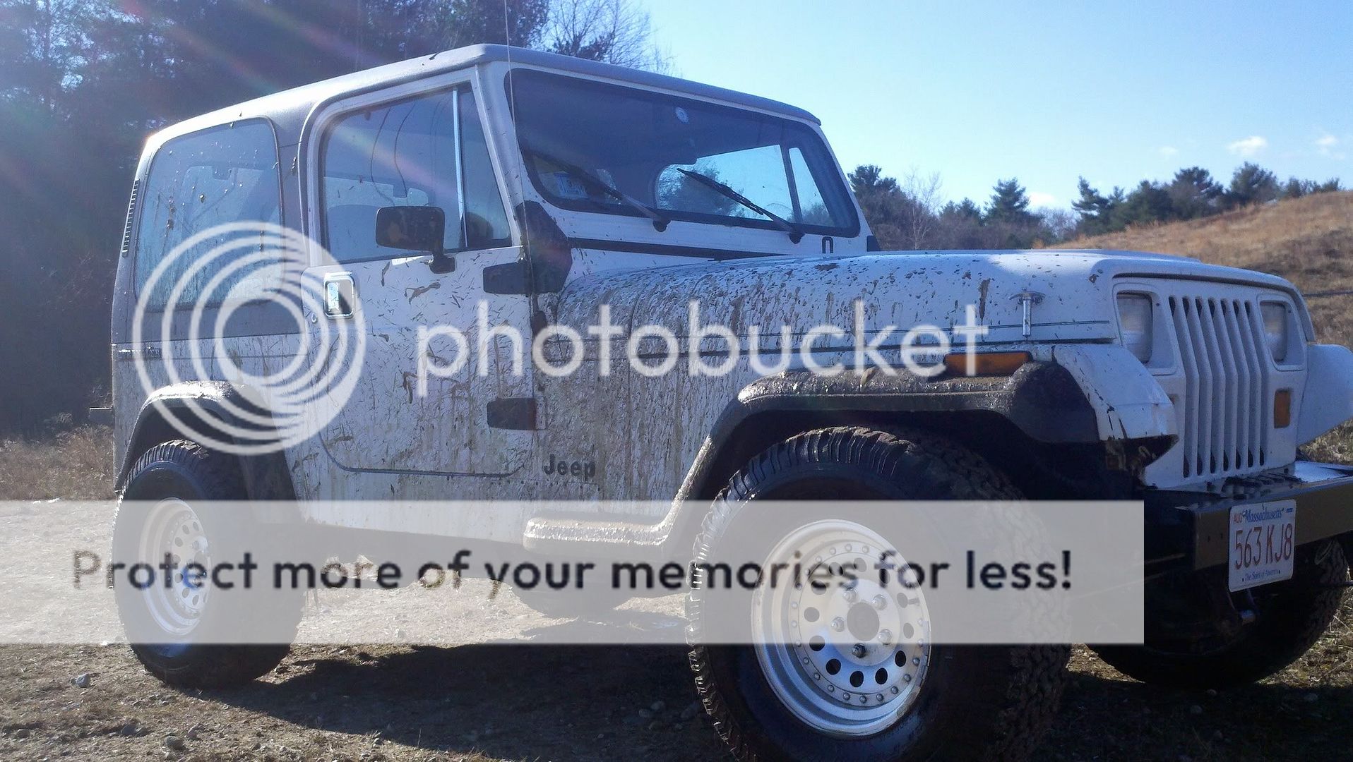

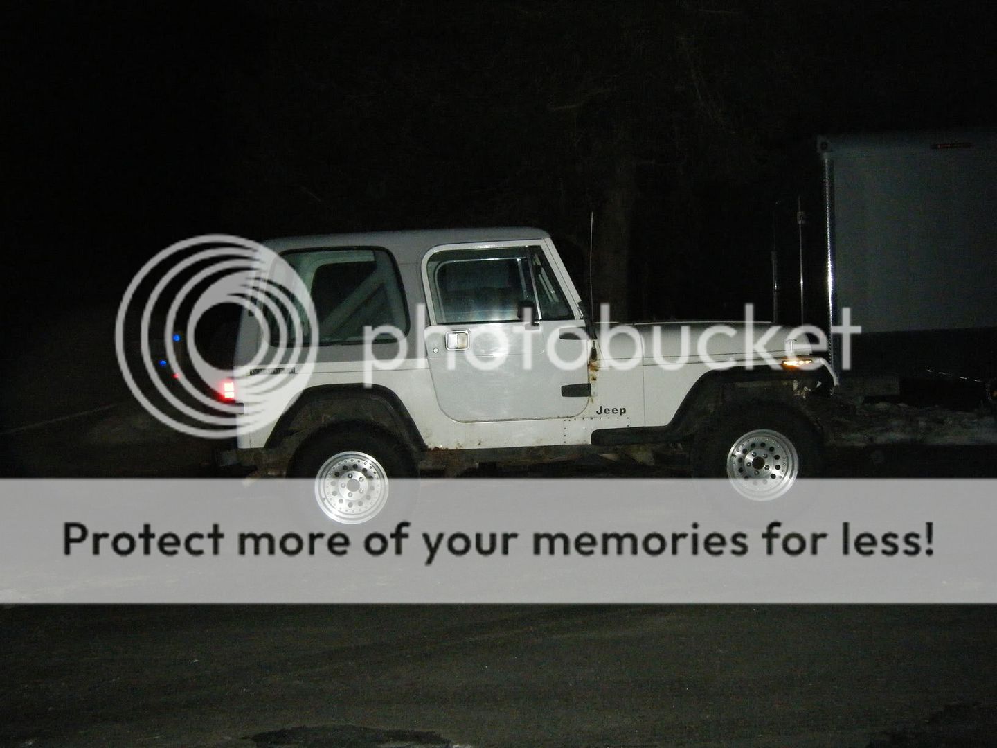

I finished the bastard pack on Monday but I haven't had time to post up some pics so here they are. I gained about 3" all the way around using the main S10 leafs in front and the second leafs in back.
Before
After

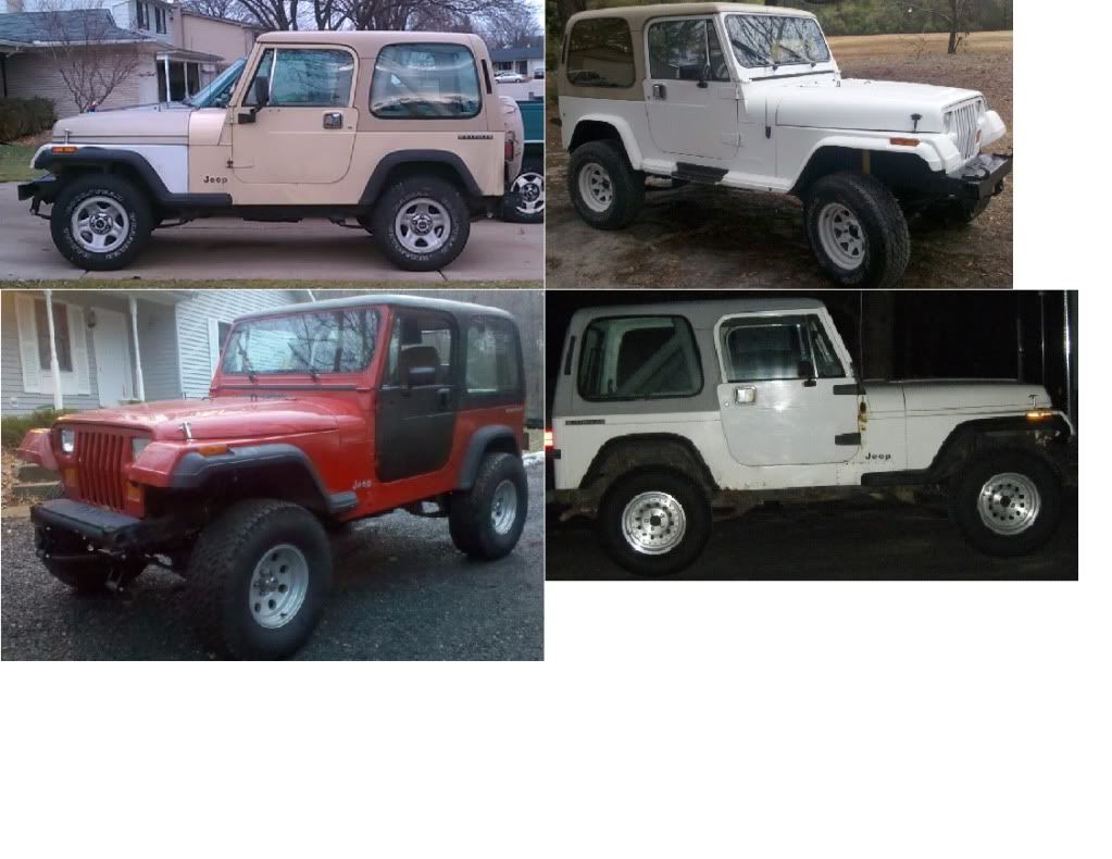

All the after pictures combined into one shot........
