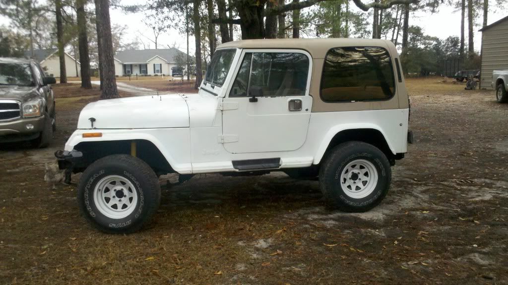

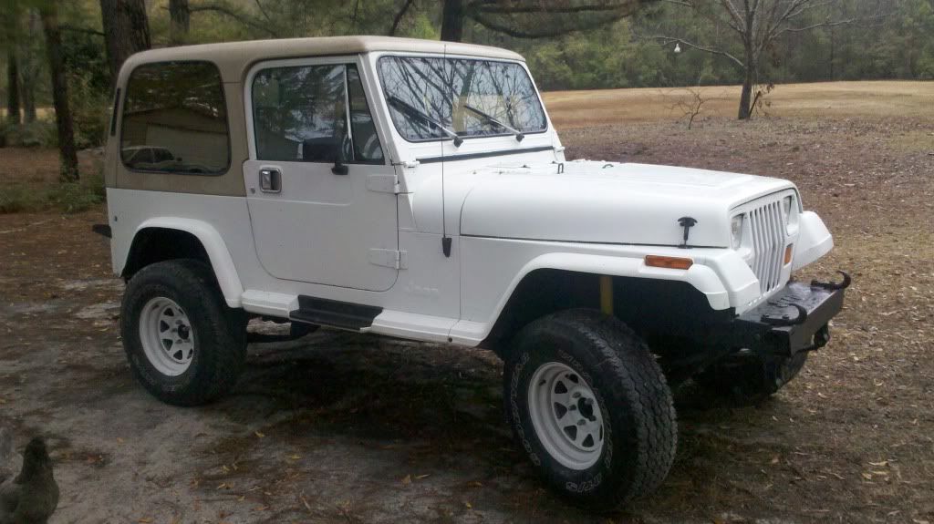

ok all done. 2 inches of lift gained with yj mains. the best part is the ride is pretty nice, its not harsh at all. but what a job! I am hurting in places I didnt even know I had. Turns out I had a broken spring aand didnt even know it. The pas rear eye was broken in half. when I went to cut off the bolt I was looking at the bushing. Gave it a little push and it was off.
I had to use a 4.5 inch grinder with cut off wheels to remove the body bushing bolts. I was going to use a sawzall but the hardened steel bolts and bushings just ripped the teeth off the blades. And I had one of the clamps break, that was a bad moment there. but I used one from the donor pack ,and a bolt made for a pretty conveinent rivet. It was time consuming. but it was fairly cheap. Less than 200buks total. I could have been cheaper but the guy I bought the springs from charged me 100 saying they were re arched.... total bs. and it cost me about 90 for bolts and bushings. I have since found the body bushings a bit cheaper. about 10 rather than 15.
The worst part was rebuilding the packs. a very dirty job. lots of cutting and grinding.
one bastardized pack
front height before, I forgot to take a picture of the tape measure.
rear before
front after
rear after
here's one of the broken eye, for fun.
the finished product!

OK I just took her out for a decent test run on the E-way and around the house, very minimal vibration that may or may not have been present before the lift. Overall it seems to have helped the vibrations I was getting before the lift. I can actually use the rear veiw mirror without holding it now.
The ride quality is way better than before the lift. It must be something to do with having a positive arc in the springs rather than a flat plate. I am getting a bit of steering wander, not a lot, but enough to notice. Also, no more tire rub when I turn to the stops.
Over all WELL worth the time and money, I am super pleased with all aspects of this "lift".

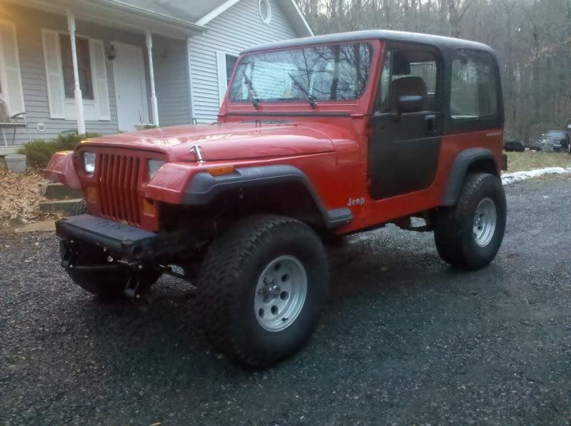

you inspired me to do this to my yj also and it worked for me that i still had 4 of the second to longest leaves from 2 diffrent s10s that i had lowered in the past and so i used them and added more bushings and some 1" booms and i got almost 3.5" of lift here is a pic
