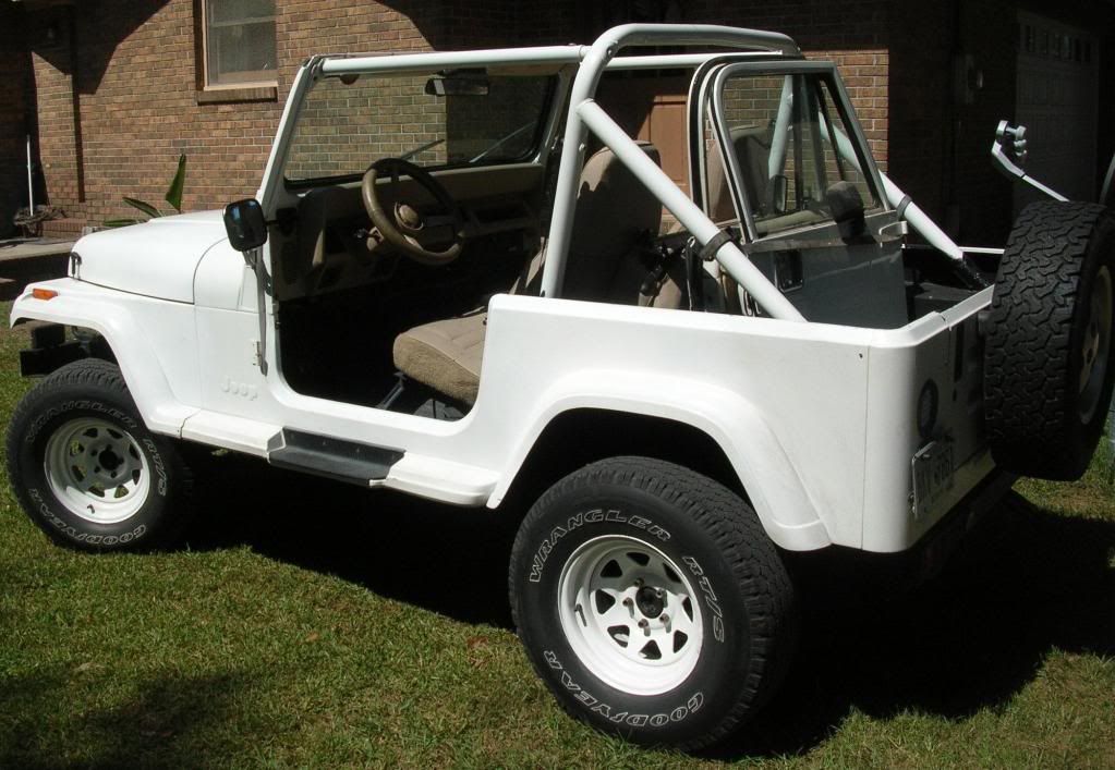

post #27 of 235 Old 09-16-2010, 01:20 AM Thread Starter
five-string
Location: Way South
Posts: 234
Here' s a photo with the wagon wheels on...
And then I removed the roll bar padding...
I need to trim the flares before I decide on any more lift, via either body or springs.
