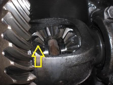

post #45 of 86 Old 03-17-2011, 08:26 PM
Nibbley15
Location: Pensacola
Posts: 340
I was doing this maint in your write up, and took a bunch of pics to see a "before" pic, my question is if this wear is normal, or is my D35 about to do something bad?
It appears to have pitting on the spider gear on the left side, and the ring gear has some wear on it, again not sure if this is normal.
I put a yellow arrow on the possible pitting.
