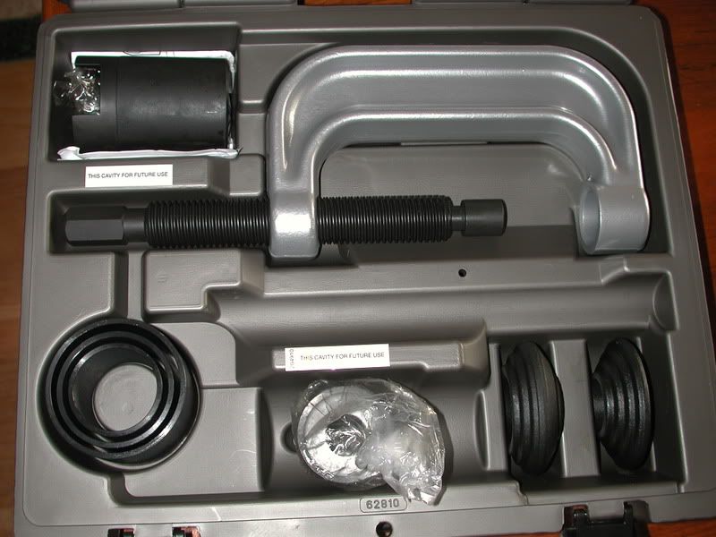

You need one of these:
There is a specific Jeep adapter needed as the top of the C is angled. There are some good writeups I'll try to link in a moment. I went with Moog Joints, likely could have got away with something way cheaper, it's just what I did.

I just used the Loaner press from Autozone..... As for the angled cup, I shimmed the flat cup to work. After the first one goes in, the othe 3 are a breeze and the whole job take less than an hour if you aren't fighting seized hardware.

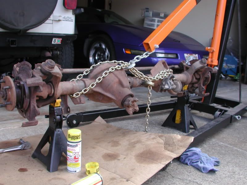

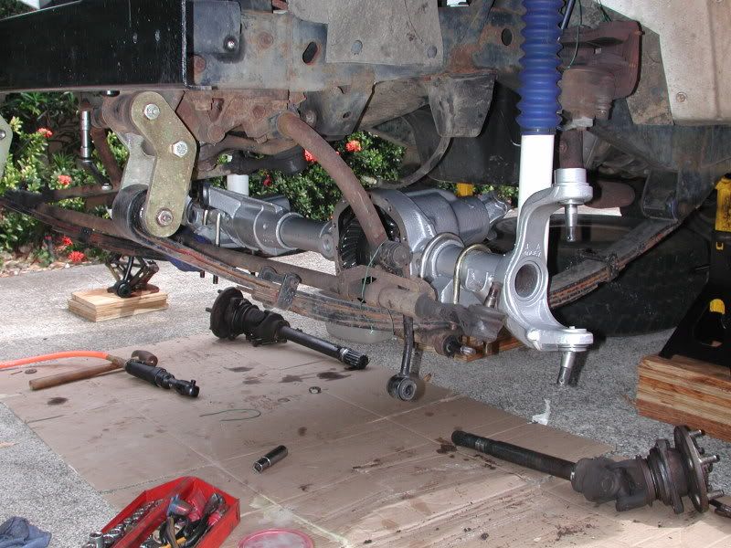

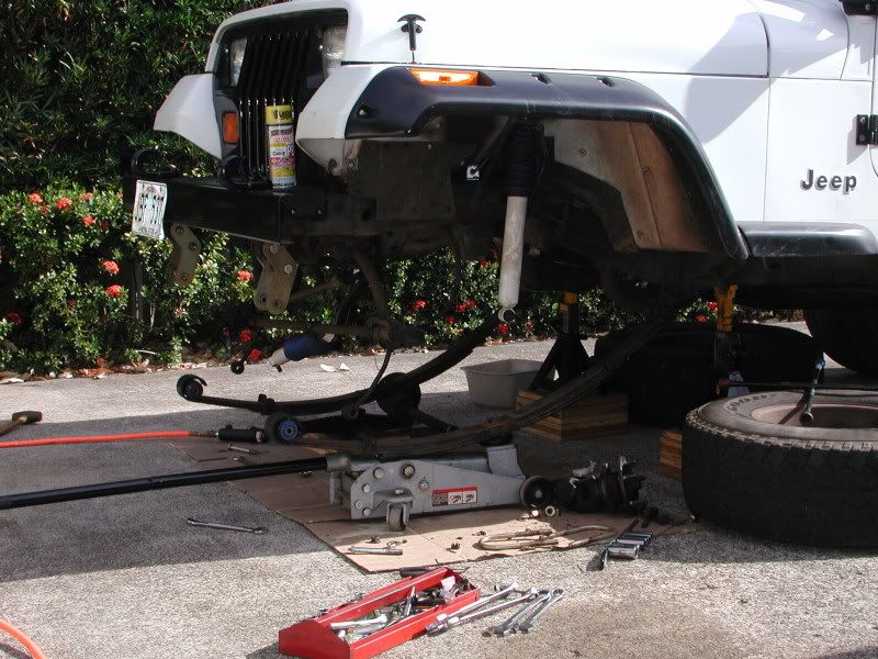

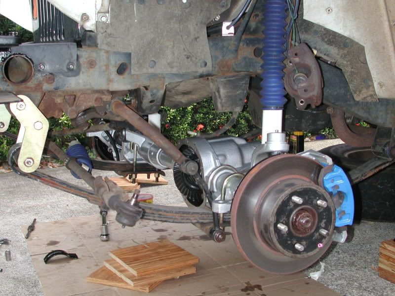

Maybe I wasn't clear, or also misunderstood the question. My impression was that I was asked if it is necessary to remove the axle, and no, I didn't remove my axle to just do the ball joints. As in the photo I posted up, I did remove the Axle shafts of course. So what you call an axle, I call an axle shaft, while what you refer to as a shell, I call that an axle.
Yes, I concur. One needs to pull the axle shafts to do the job. But you don't have to pull the entire axle.
So I pulled Axle #1.
I had already been cleaning Axle #2,
And slipping in the Aussie.

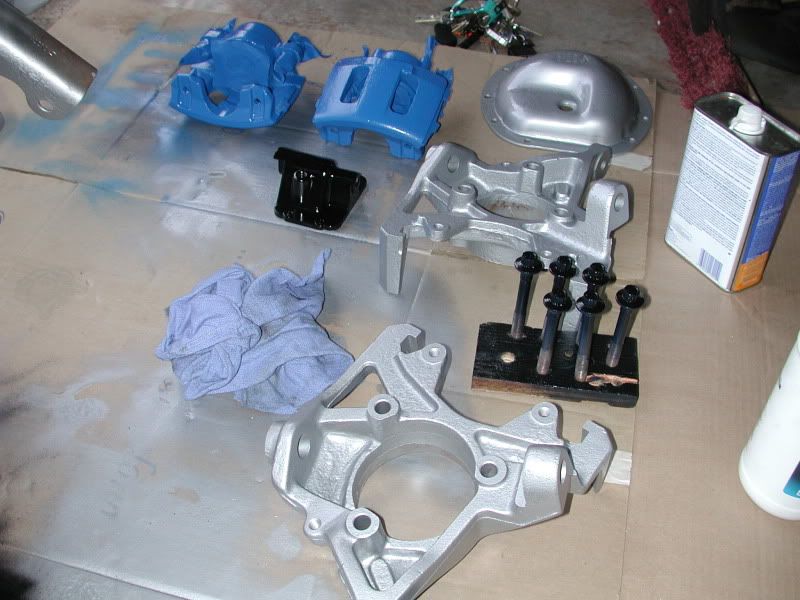

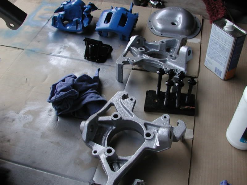

and then bolted Axle #2 in the Jeep, and then put in the ball joints as in this photo (axle shafts on the ground gathering up pieces of grit and cat hair)
Then smiled and drank beer.
