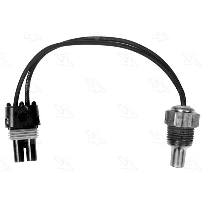

I havn't had my 2.5 in a while but I believe the CTS is on the intake manifold. It has a water passage in the intake that it goes into.

I was thinking that was the MAT sensor. I need to look at my chilton book.

The MAT sensor is on the top side of the intake from what I remember, the CTS is on the side. (I think) Here's a pic of the sensor.
