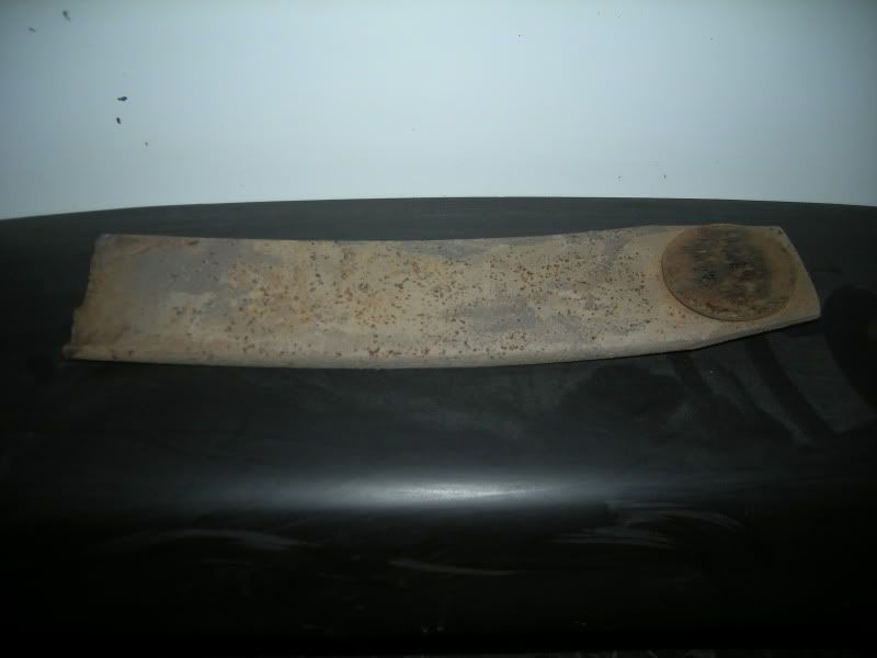

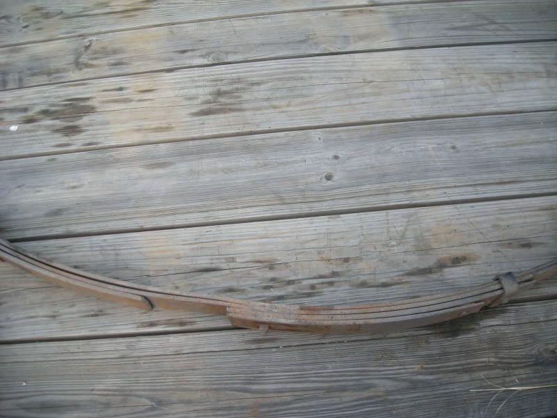

Axle wrap, something I thought the 2.5 couldnt do
and breakage
Calling McDonald & McDonald in Newburgh tomorrow. They are a spring specialist.I bought the U bolts for the Jeep from them and they make them while you wait. For less then half the price of mail order, Four wheel drive hardware wants 90 per spring. Im sure M & M can beat that!

Bringing both springs to the spring builders. I hope they can match them up to the original two inch lift and stiffness

so why why why, i must ask why you titled this "axle wrap, something I thought the 2.5 couldnt do" since it dont have much to do with the engine? Running SOA with no track, anti-wrap bar this will happen on any type suspension!
not really. this is internet paranoia. without an anti-wrap i have bent spring packs but never broke any. the ones i have now (pre anti-wrap) are bent as well but still function fine. and as we all know the track bars have nothing to do with wrap.

Agreed a bunch. It's all in the springs chosen. Stock YJ 2.5L springs, like those in the OPs photo appear to be, have near zero ability to deal with wrap. Other springs, like my 1.5" RubiExp SOA design springs have shown no bends at all after a few years of V6 power, 35's, and no AW-bar.
