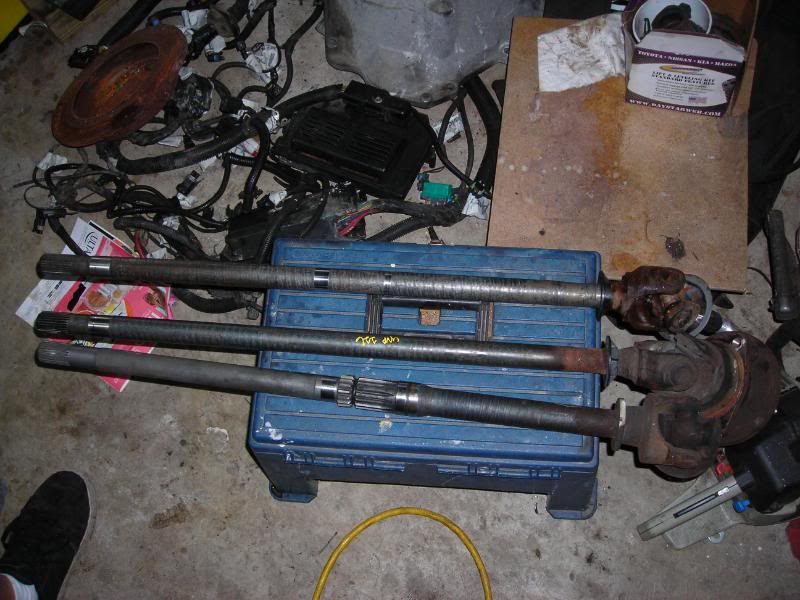

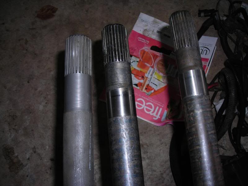

This picture shows a TJ shaft, XJ shaft, and YJ shaft.
Notice how the YJ is a two piece? The XJ/TJ shafts eliminate that. I pulled my XJ shaft for $20 at the local junkyard.
The TJ/XJ shafts also have a different yoke on teh axle shaft and take different U-Joints. This is good because the TJ/XJ U-Joints are stronger than the YJ U-Joints, although the yoke is not as substantial.
And notice the difference in oil seals. The YJ shaft has no seal in the pumpkin so a special seal must be purchased and put in place where the XJ/TJ housing have been machined for that seal.
That about covers it.
