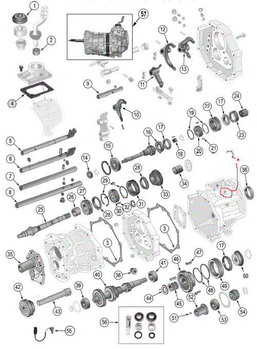

I did find this:
http://www.jeepforum.com/forum/f12/a...loose-1111389/
Looks like #2 is what I need.
The part # I gave above looks like it is just an oil seal. I need the #2 part that goes on the end of the shifter and maybe new springs on the sides.

I think it's a worn out spring in the side bolt things (see post #6 in this link: http://www.jeepforum.com/forum/f12/a...loose-1111389/)
Mainly the drivers side one. Is there a part number for these anywhere? or do they come apart and you can replace the spring?

I FOUND YOU MF"Rs !!! at least I think anyway.... anychance I can get some re-assurance? lol
#83500516 Reverse Left Hand Shift Pin
#83500515 Reverse Right Hand Shift Pin
http://www.jeep4x4center.com/reverse...-83500516.html
They are not numbered on any diagram I could find, but now that I have a part# I can find them elsewhere... Still ~$25 each... cockgobblers.

Photo number 7 in the first post, and associated text. http://www.jeepforum.com/forum/f12/m...build-1032480/
Yes, the parts you linked in your last post are what you need.
