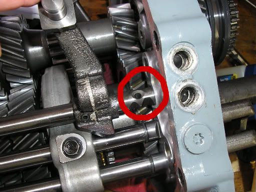

Sorry to chime in a hijack the thread again, but I've finally ripped the case open again on the trans to look for the home for that little interlock pin and god save me I can't find it. Does it simply fit into one of the grooves like for the interlock balls, because I don't see any holes in the shaft save for the one that the shift fork screw goes into. You mentioned that you might take a picture to show exactly where it goes, would a picture still be possible in your condition. Other wise a decent verbal explanation might help like is for the intermediate plate or the reverse shift arm collar that it slides through. I'm trying to use common sense as much as possible so I don't have to resort to hijacking but I can't seem to think this one through.

The interlock pin that had mysteriously appeared on the floor had come from the 1-2 shift rail.
I had to pop off the little c-clip on the rail to get it to slide out far enough to replace it.
The other rails all have to be in a specific position to allow a different one to move (I'm at work right now so I don't have it in front of me). I had the 5th gear rail out completely, the check ball from the reverse rail out. Had to move the reverse rail back and forth a bit until I found the right position to allow the 1-2 rail to move. (Don't freak if the interlock pin falls out of the reverse shaft, you can get it back in without pulling the rail) I suggest before pulling too much apart move the rails around a bit to get a feel for how the move and which has to move first. AX15 shift rails is much like a Rubik's cube it seems. Don't be afraid of it, you 'll figure it out.
Most importantly DON'T FORCE ANYTHING! It WILL move if everything is aligned correctly.

Yeah I had found the home for it just the other day. When I did the rest of the rebuild, I had only removed the 5th gear shift rail and that was when I heard the pin (I just thought it was one of the balls) fall out. Therefore I expected the pin to be somewhere on the 5th shift rail, finally after studying the FSM some more I came across a figure that shows the position of some of the pins and balls. After sliding out the reverse shift rail a little bit, I saw the hole for the pin conveniently hidden under one of the detent balls.
dude that diagram is AWESOME I'll have a blowup of that pic on the bench when i eventually get back to it!!! Thanks
