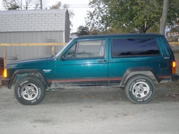

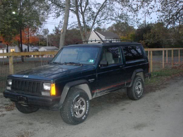

Well guys the plans changed a little (gee what else is new). Heres my new ride.
95 cherokee 6 cyl 5 speed manual with the ax15. Got it for 1300. So heres the new plan. The wrangler is going to stay off the road. I finally have the money for the bearings. I'm going to get them and finish the tranny. The tranny is also going to stay out. The rebuilt tranny will be a spare for the cherokee and the motor out of the wrangler will also be a spare. Once some money is saved up (like 20 years from now) I can start on putting the 350 in it. I really need the cherokee for work and to transport my puppy (my shepherd is 94 lbs now and doesn't fit on the front seat of the wrangler anymore) As soon as I get the bearing kit and start on the assembly process I'll be back. Thanks guys
