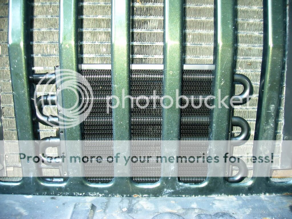

This is where I mounted mine:

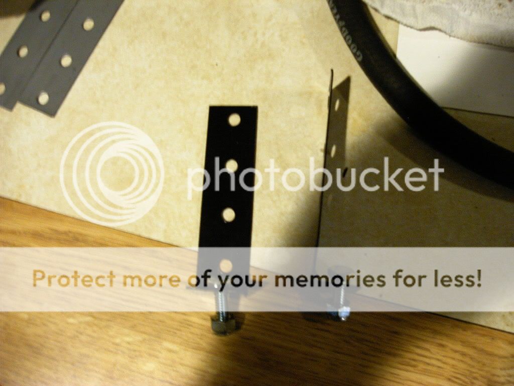

On these:
While I wouldn't recommend it, It'd be ok to mount it directly to the engine radiator, no issues.
Make sure to keep the cooling lines routed through the heat exchanger in the engine radiator, before the aux. cooler. Water/coolant conducts heat better than air, so your best cooling is done by the exchanger.
