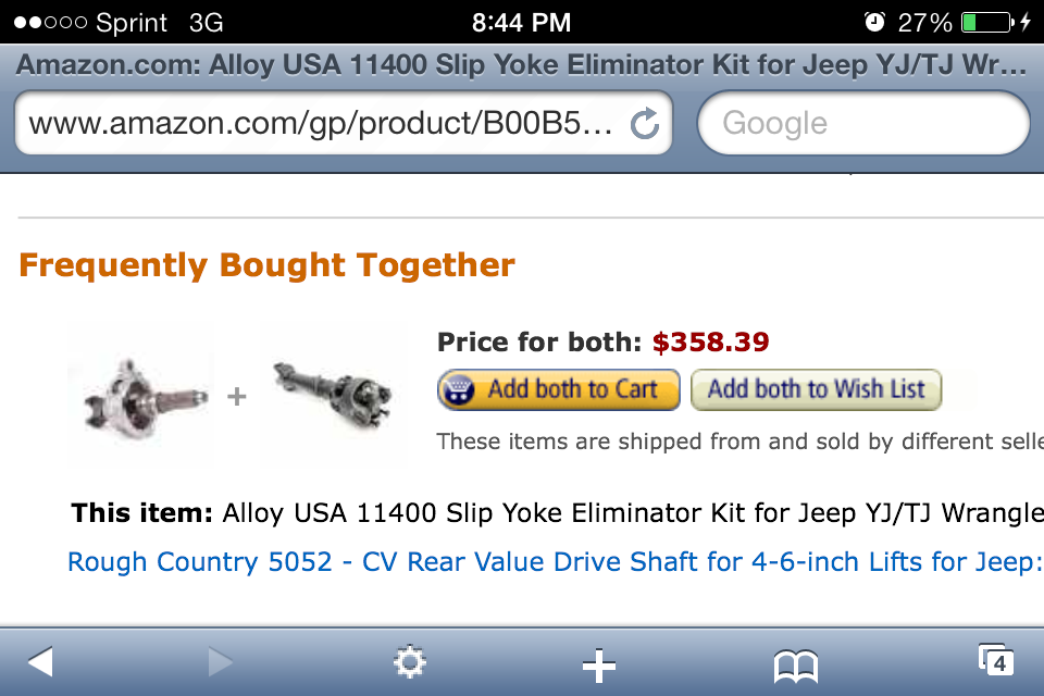

has anyone tried out the Alloy USA SYE? How about the one size fits most CV Driveshaft from Rough Country? Seems like one heck of a deal over Tom Woods and Teraflex…
http://www.amazon.com/Alloy-USA-1140...sim_sbs_auto_3
total for both is $358
possibly the answer to my vibes at low speeds but I only want to do it once, and I'm trying to hold out until i find a rear axle.
Edit** a little more research reveals that the rough country drive shaft is made by Tom Woods. So I imagine that would be the way to go.

Chris this is where in seeing the price,,
And the few reviews I have seen say the shaft fits on all of their jeeps.

That cv shaft on amazon by rough country for $200 is for a tj which means it will be on the short side for a yj.....
Try this: Driveshaft SYE combo $425
the same part number in another link for more money calls it a tj 4-6" and yj 4" shaft.
