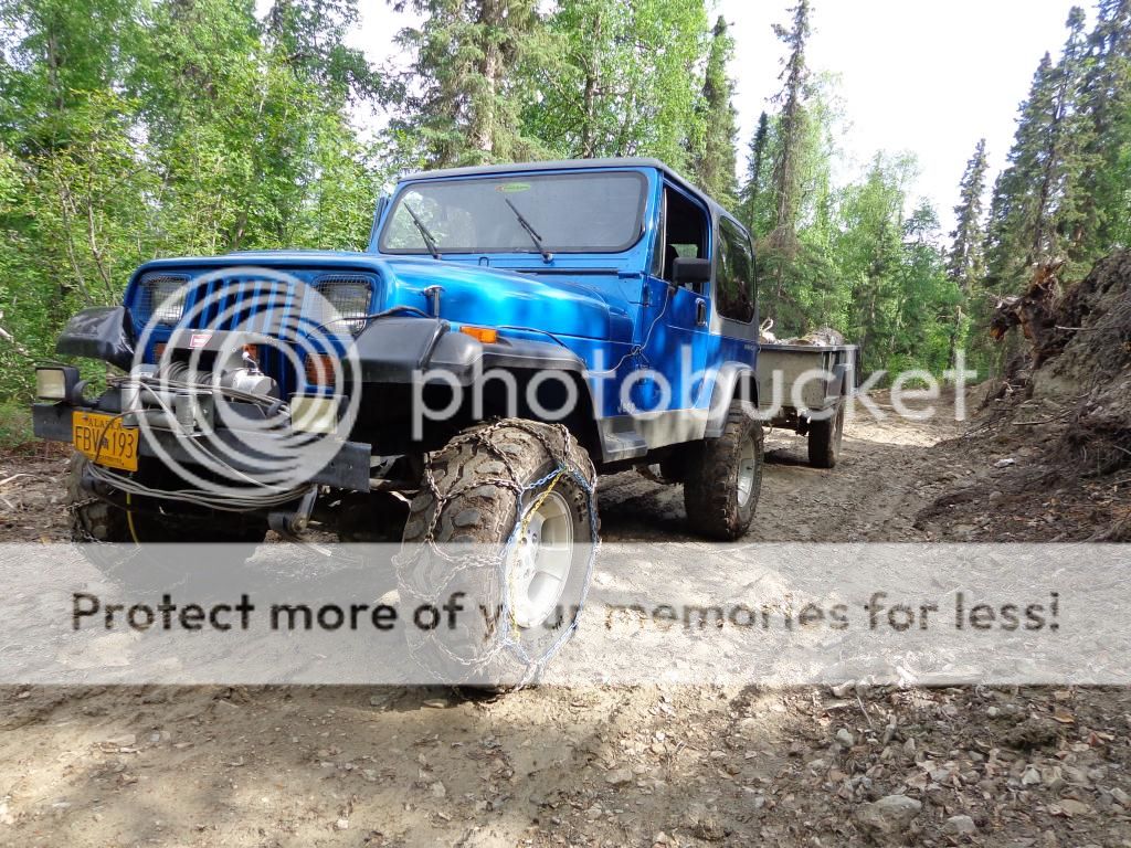

OK, mine are not full wrap, they are full wrap on one end but not the other. The other end the second leaf starts to wrap but not completely. My records show that I bought them in May 2006, so I guess I have had them on my Jeep for 7 years, not 8. I like the springs, seem to be holding their own, even though I use the Jeep for some heavy trailering, hauling building materials and firewood in a military trailer. I think they ride pretty nice, but had Rough Countrys before, so maybe I don't know what a soft riding YJ is like. I have a 1 inch Daystar body lift and even with the 1 inch boomerang shackles, I don't think it looks too tall with 33s. Here are a couple pics.

No problem, the videos were already on Youtube. Yeah, it does seem like the springs are pretty tough, with the trailer loaded the rear settles a couple inches, but they return to where they started at least so far. I have used it pretty hard the past three years, hauling firewood over some pretty rough stuff, stumps and such.
I am not sure the reason for having a full wrap on one end of the spring and partial wrap on the other, I figured maybe clearance issues at the shackle ? I installed them so the full wrap end was at the solid spring mount and the partial wrap was at the shackle.
