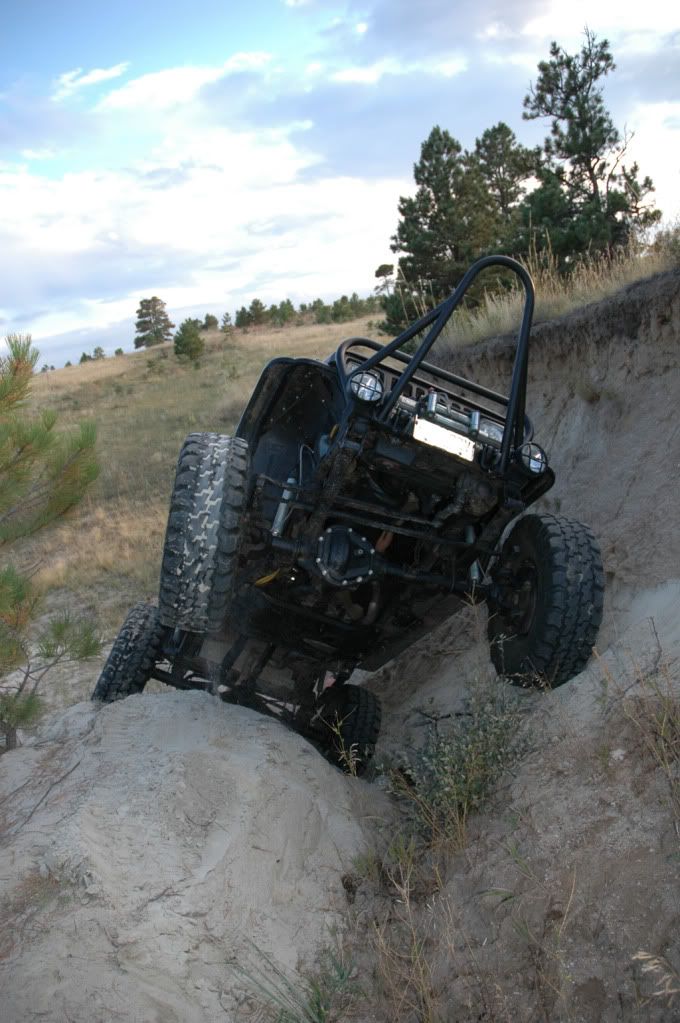

Low cog is relative. Try running 40s on your sua jeep. I'm not saying it can't be done because with highline fenders, re constructing the tub, and serious bump stopping it can probably happen. For me my low cog rig will have 1.5in of lift soa and be sporting some 40 inch rubbber on one tons.
here it stands now with 37s
90 YJ 102 in wb stretch, SOA, dana 60, 14 bolt welded,4.56s, 37in Parnelli jones dirt grips, currie twin stick dana 300, york oba, tractor link traction bar, full custom armor,poison spyder tube fenders, 95Cherokee High Output 4.0
