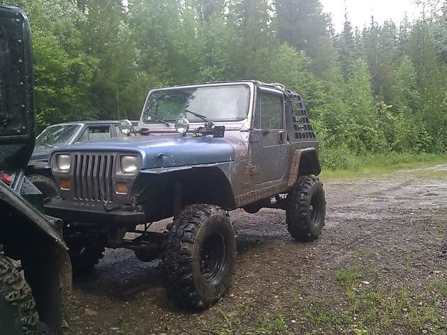

SOA with 3.5" lift springs, just give me LOTS of flex room..... but ya going bigger next spring...
I looked at the kit as well, but really all it gives ya is perches, which you can get anywhere, some ubolts, I got at my local springs hop, ubolt skid plats, meh, whateve...
so relocation brackets, which I dont run tracs or sways so... I pieced it together from other sources, and locally.
Started with some rust repairs ended in a SOA...
family roll bar swap/upgrade..
1990 YJ. SOA, OME 36R 3.5" lift springs, OME 5/8 greasable shackles, OTT high steer, Custom cage, team Rush, Posi, 33 TSL swampers
