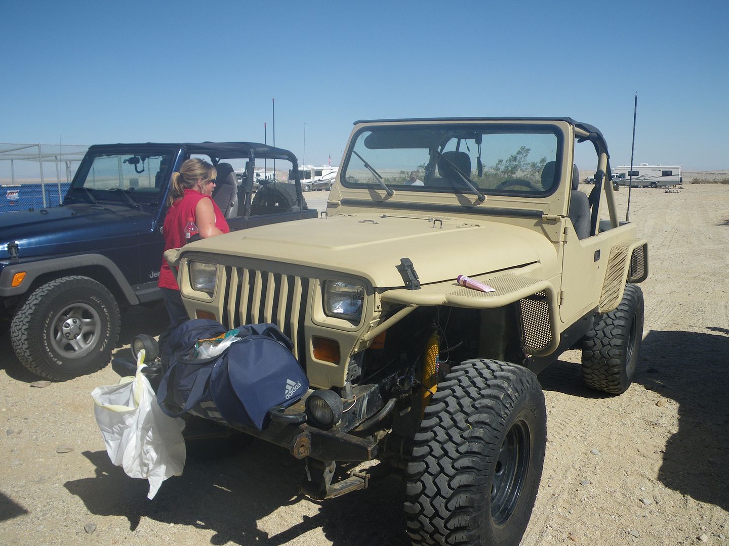

They're not perfect, but they work and are extremly sturdy.

Originally Posted by alifted4x4 View Post
Red Jeep....wow those look GREAT!! Can you post or send some more pis of those and any details. I am wanting to do mine.
Me?
I just removed the fenders (they were beyond rotted), separated the inner fender well and made some templates for the flat steel and bent everything by hand. It uses 3/16 plate on the back and 1/8 on the top. Hand formed straps that bolt on to the existing fender bolts. I'm 6'2" and 270lbs and I stand on them all time...so they're not going anywhere.
Let me know if there is a specific shot you want and I can try and snap some tonight.

Originally Posted by diabloed View Post
Me?
Yup you.... I think they look awesome...
Me and a buddy have been talking about doing that to mine,,,we just have not figured it all out. What size pipe did you use on them? As far as the pics any and all would be great! I appreciate all the help I can get.

The pipe is 1 1/4". I went out to take some pics and everything is covered in mud so it'll have to wait till it gets washed to really see much. Just PM me if you start working on it and need some specifics or a certain picture.
