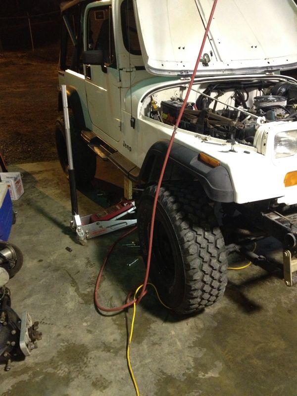

It had a 3" BL on it, had to cut it down to a 1", and found a set of 2.5" EMU leafs with bushings on Craigslist for $150....
Cutting the BL down to 1"....

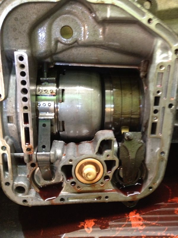

After driving it for a couple of weeks, the transmission started acting up. I assumed the clutches were coming apart from the water in the trans. The jeep had to sit for couple of months while I finished another project...
This....
To this....
Back to the jeep....

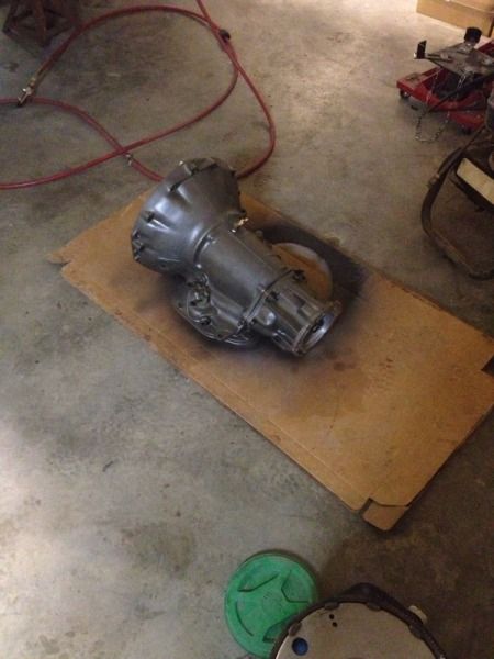

Couple of weeks ago I was able to get the jeep back in the shop. I tore into the transmission and sure enough the clutches were falling apart. Installed all new steels, clutches, seals, and bushings, and a converter. Come to find out the PO had installed a torque converter that was externally balanced which was causing a vibration at a high RPM and broke the flywheel!
Finished product....Also did the vent relocation....
Got the trans back in and installed a couple of other Craigslist deals....

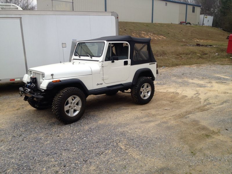

and this is where it is at today....

Wow. That has made me make my mind up right there. A white YJ with the 17" MOAB rims off a JK rubi. Done deal. Those are what I want. I assume you got the wheel adapter right? Which ones did you get and from where? Thanks

Yeah I was surprised myself, I planned on blacking them out but I liked them how they were once I got them on. As far as wheel adapters I got a set off of eBay, I don't think they are hub centric, but so far so good. I am going to retorque them after a couple hundred miles. The seller was lugs-n-stuff.

I used an app on my phone to check the speed and best I can tell its off by 4 or 5 mph. I think the tires figure out to be 32.1" tall.
