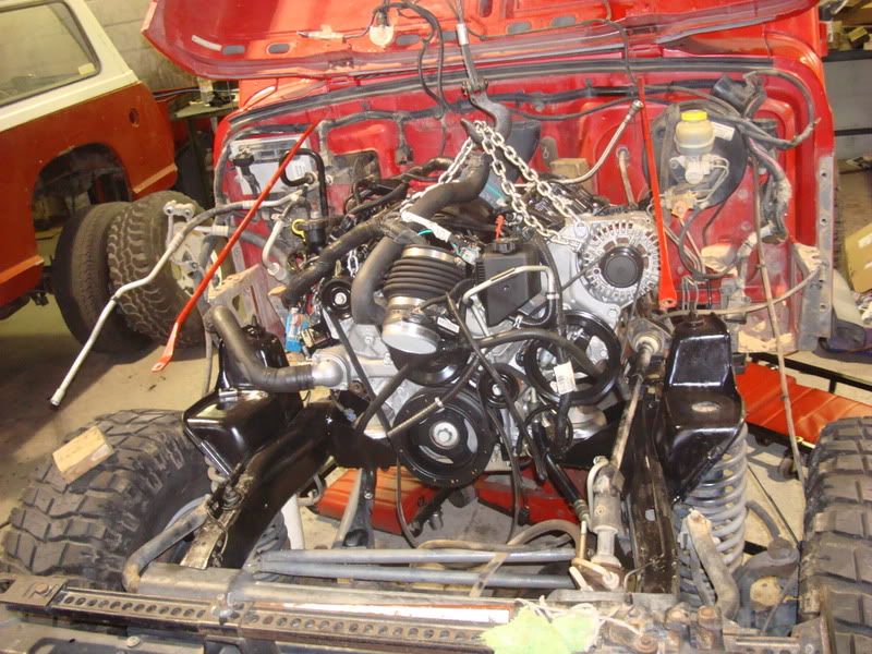

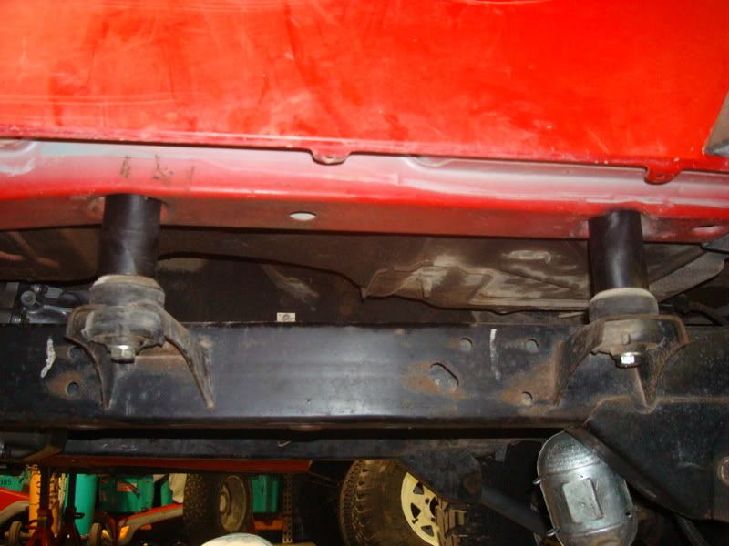

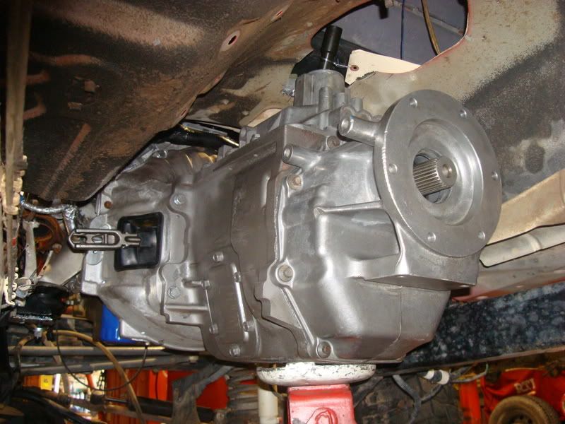

Anyone who that tells you a 3" body lift is necessary for an engine swap has no business doing engine swaps.
This is where I got the info..
Originally Posted by Curlee View Post
UPDATES
Thats the engine, actually bolted in. They are still doing some adjustments, so its still on the lift.
Unfortunatly due to some clearance issues with the tranny, a 2 inch body lift was needed.
And theres the 2" body lift.

That looks like a 2" body lift stacked on top of another 2" body lift. Some shops downright frighten me.

Yeah thats a 3" body lift. They're looks to be plenty of room to slide up the trans without that body lift or just cut your floor. You should go look at Chadroc's 6.0L build.

yea, he made a mistake it is a 3"
