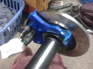

Put some 8.8 disks on the 9"...
This. I'm running a ford 9" w/Detroit locker. Love it. Threw some 8.8 disc brakes, love it even more.

That looks damn good Apollo!
