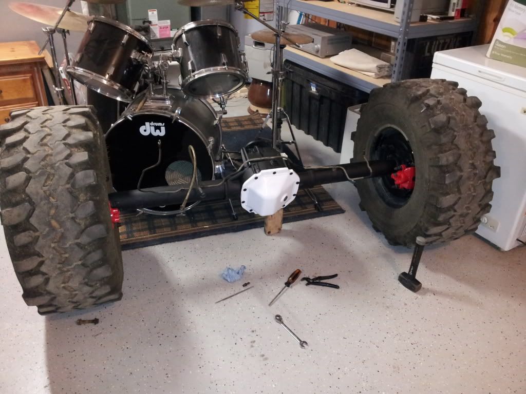

I reused, cut down, re-bent and re-flared my Jeep hard lines and the Jeep rubber line. And I mounted all the line to the 8.8 breather block, if memory serves. That and the two passenger-side banjo ends.
Picture of the 8.8 getting Jeep lines.
