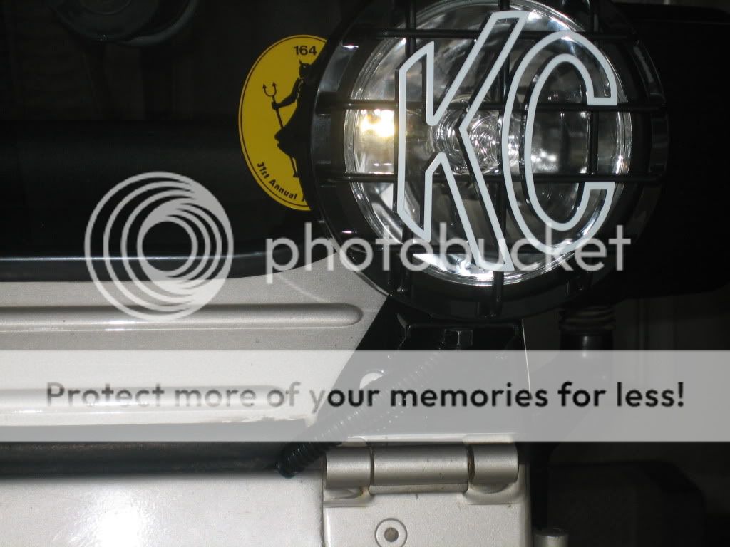

post #42 of 50 Old 06-11-2011, 10:07 AM
plumber1
Join Date: Jan 2007
Location: San Ramon
Posts: 2,418
Attachment 229542
Attachment 229543
Attachment 229544[/quote]
Add some plastic wire mold and i will clean up your exposed wires.
[/QUOTE]
I LIKE THAT!! I'll definitely have to grab some once... Once I get her back on the road! Thanks a lot!
