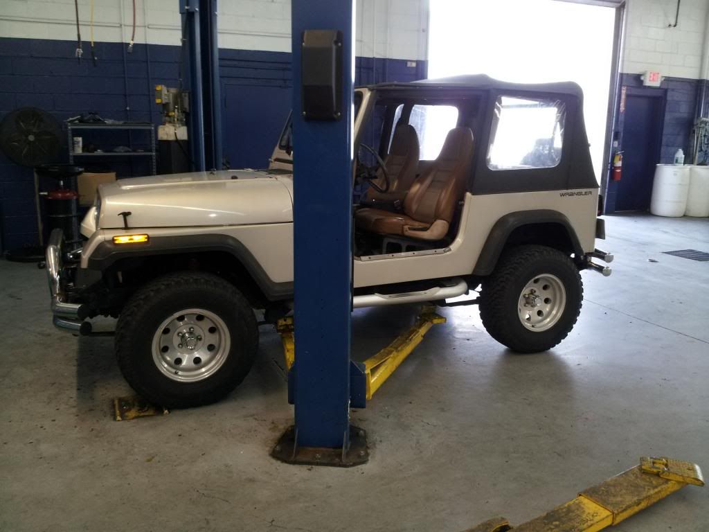

Also settled on the JCR full front bumper with one hoop. Just waiting one everything to show up. I'll try to document the install with before/after pics and measurements. But Ill prob. lose track of time and forget to take pics along the way. Til then, here are some teaser pics of the vehicle in question first with a 3in body lift and 31s then with the booms installed and 33s.

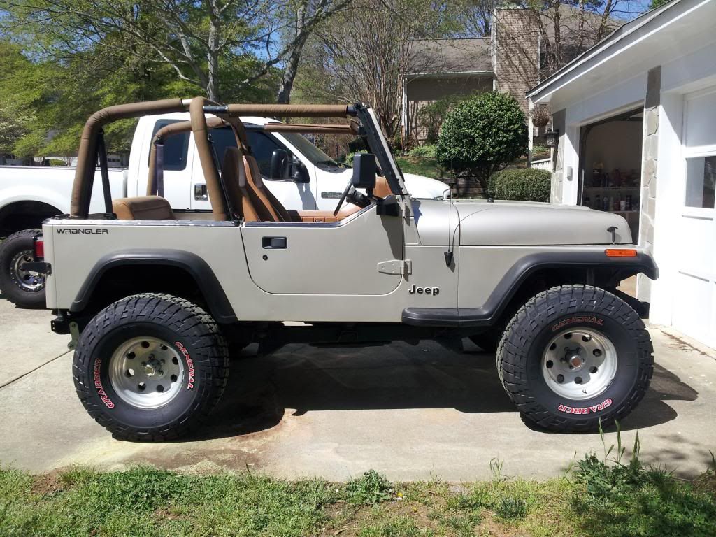

Ended up getting the lift installed. Still have a few things to button up, but here was the end result. Also started a build thread with more pics.
Rides like a Caddy compared to the old/siezed stuff. I think he'll be happy.
