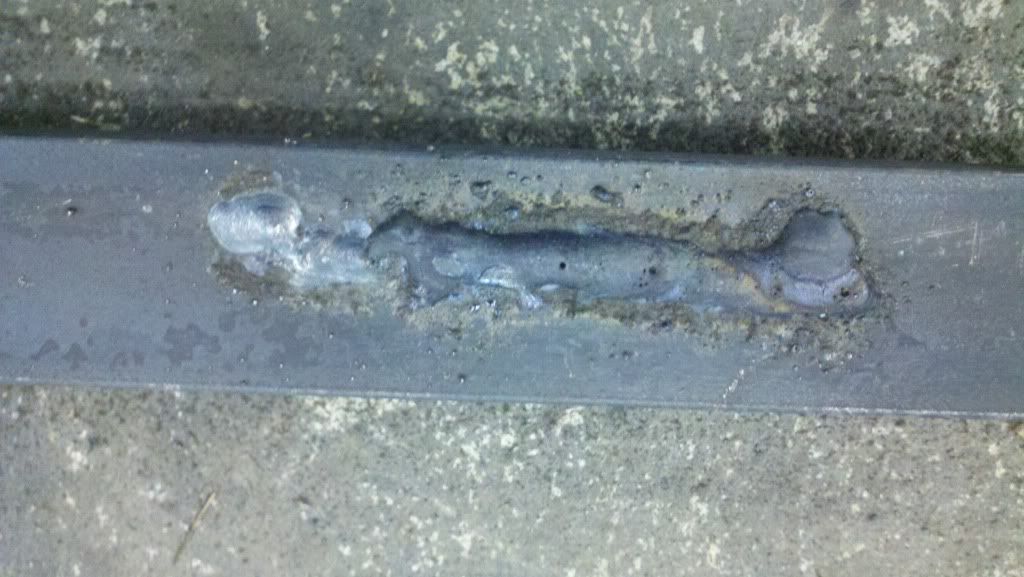

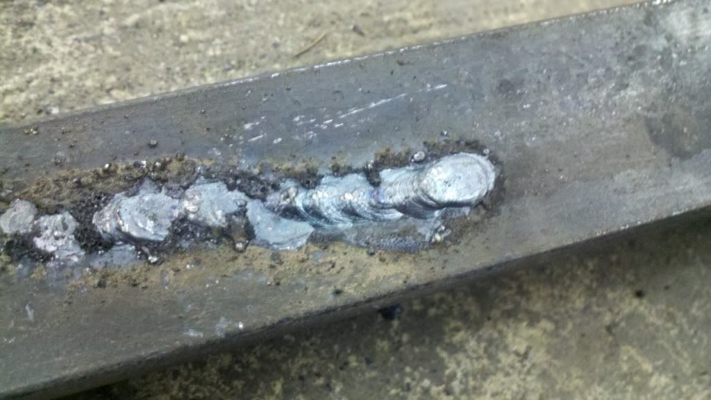

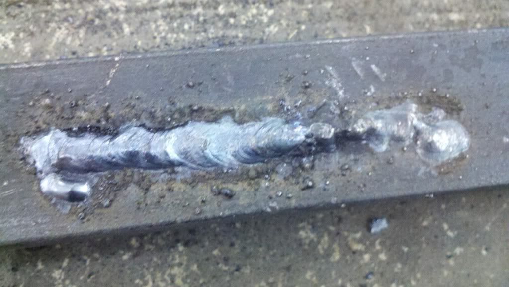

so heres a little comparison, given im absolutely terrable at stick welding this shows the bead i was able to run, (this is only my 3rd time trying to stick weld)
alternator welder
220 mig with gas
build thread:
1997 ZJ limited - BONE stock
RC vs BDS
Ripper3494 is offline
post #72 of 141 Old 12-15-2011, 03:29 PM
oldtime_ironman
Location: 14304 Niagara Falls
Posts: 2,537
Looks like you were using 6013 rod, or maybe 6011? Certainly had enough heat there. Maybe could bump it up to 7018 (my favorite) and practice a bunch. I had tech school + college and 3 yrs experience before they let me weld anything on the job.

im looking at the box and i dont see where it says what it is... its 1.6mm thats all i see
build thread:
RC vs BDS
post #74 of 141 Old 12-15-2011, 03:54 PM
oldtime_ironman
Posts: 2,537
Look on the side of the rod itself, near the stinger end 1,6 mm would be about 1/8 inch if I have my math right, so it seems your setup is capable of using the full-size commercial stuff
oldtime_ironman is offline
post #75 of 141 Old 12-15-2011, 03:56 PM Thread Starter
Ripper3494
Location: Warrenville
Posts: 5,741
found it, your right 6013, says on the rod itself
