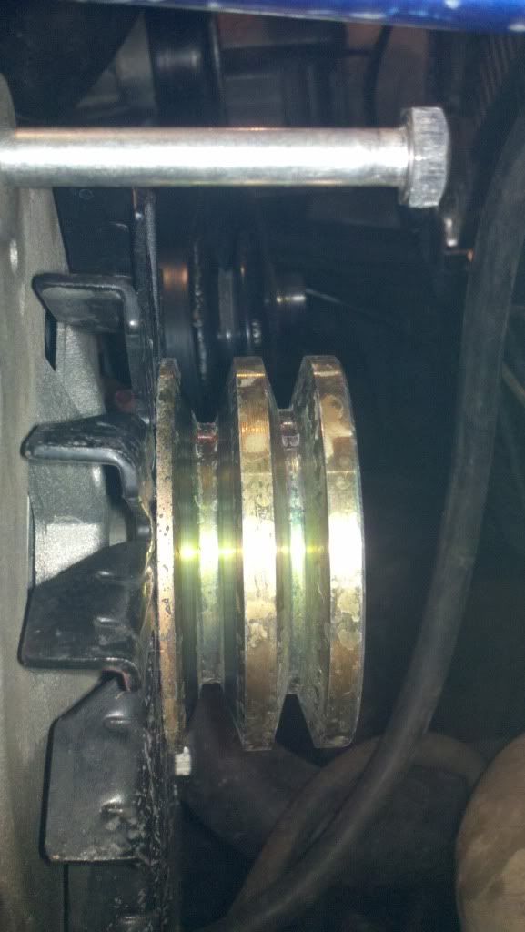

perfect, ive been trying to find a smaller pulley for the alternator, and a bigger one on the engine, idk if you can see from the pictures but i just welded another v belt pulley onto my tensioner
Yep, I see it. If I remember right, a 1/2 dia pulley hole fits most alts. Might have to hone it a bit. Imagine what it be like if you put a tiny 2-inch pulley on the alt and a big honkin 10-inch air compressor pulley on the crank!
