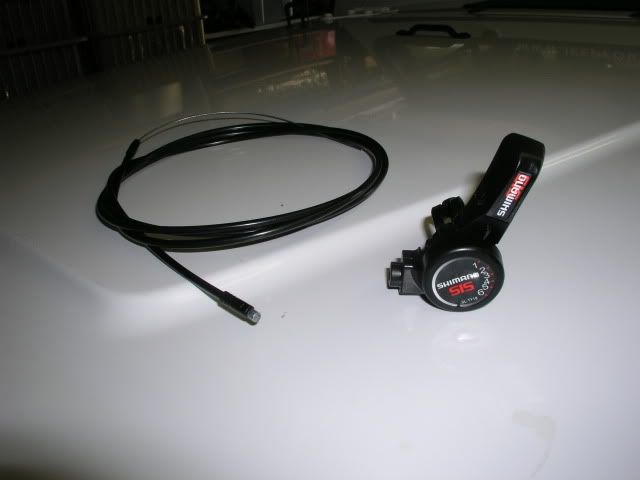

I would also get a hand throttle, with a bicycle shifter. That way you can rev the engine while winching outside the Jeep.
