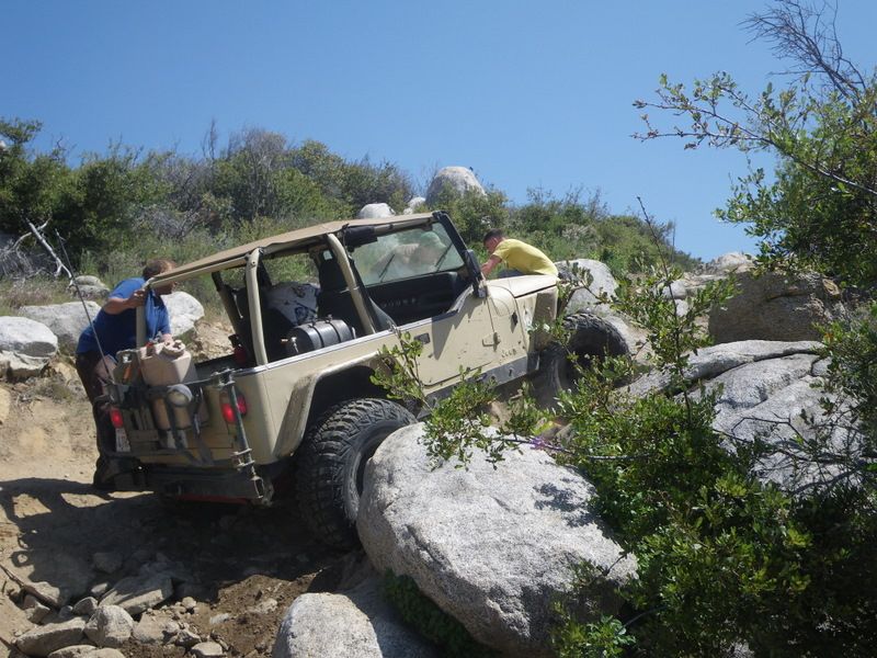

Have mine on the rear fender. I think it's about 3g.
jbolty is offline

Dude, nice YJ.
My wife is telling me just to put it under the Jeep where I had the other tank. I'm thinking it may work best considering that when the family goes wheeling, there is no room inside the Jeep for an air tank.
